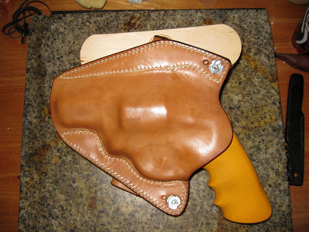

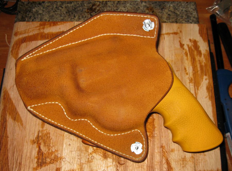

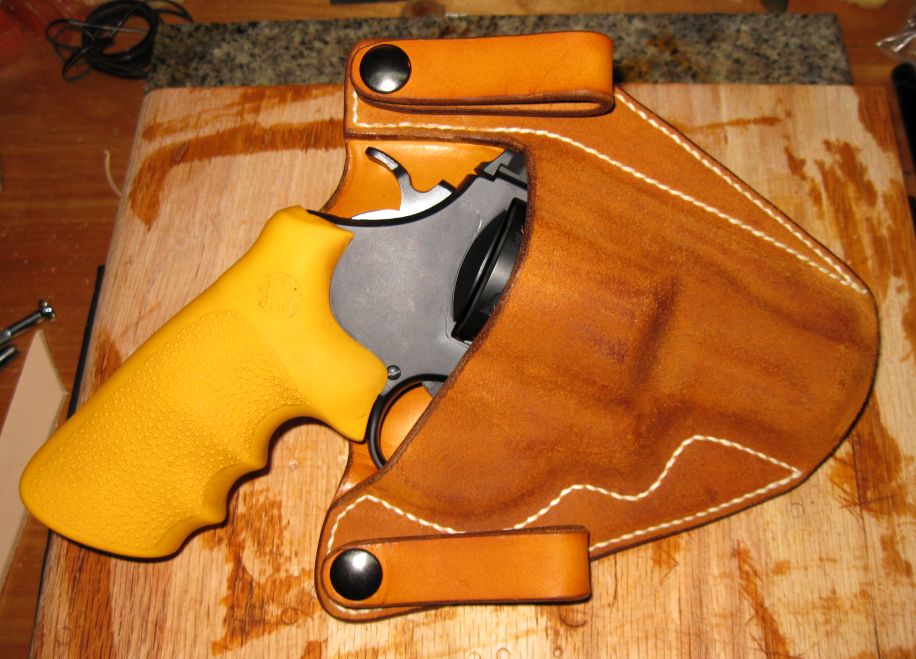

MADMAX22 Posted April 22, 2011 Report Posted April 22, 2011 Hey everyone, been a while since Ive done a holster and have only done a few to begin with. Doing this holster for a buddy at work and wanted a little input as to how its progressing. The final one will be done in horse hide as he wanted. Pretty much the overall design is what he wanted for the most part. The only thing I have changed since this one is right where the rear site is the top layer of leather I trimmed back a little bit because when I was drawing the gun the rear site would catch on that top piece of leather. Anyways let me know what you all think. Quote
Members Rayban Posted April 23, 2011 Members Report Posted April 23, 2011 Hey everyone, been a while since Ive done a holster and have only done a few to begin with. Doing this holster for a buddy at work and wanted a little input as to how its progressing. The final one will be done in horse hide as he wanted. Pretty much the overall design is what he wanted for the most part. The only thing I have changed since this one is right where the rear site is the top layer of leather I trimmed back a little bit because when I was drawing the gun the rear site would catch on that top piece of leather. Anyways let me know what you all think. I like...good sturdy work, and design....can't help but wonder why he would insist on horse hide...what difference can it make for an IWB? Quote Raybanwww.rgleather.net

MADMAX22 Posted April 23, 2011 Author Report Posted April 23, 2011 Not sure Rayban, I think it was a mistake of mine actually. I told him I had both horse and cow. I guess that the one place he was looking at charged a hefty sum for horse hide so that correlates to better for most people. I dont mind either way and explained that one is not better then the other overall. The main reason he is having me make him one is the front site is a after market site that they dont generally make holsters to accommodate so I told him I would make him one for a small fee but that it wouldnt be quiet as nice as some of what you guys make. Dirtclod yeah I am not overly impressed with the grip. Its a pretty nice revolver for what it is but I think I would definitely change it out. The thing is super light though atleast without ammo in it. I imagine it kicks like a mule though. Quote
Lobo Posted April 23, 2011 Report Posted April 23, 2011 (edited) I like...good sturdy work, and design....can't help but wonder why he would insist on horse hide...what difference can it make for an IWB? Horsehide tends to have a very dense structure that resists moisture infiltration more so than cowhide, which gives some advantage in IWB-style holsters that are subjected to moisture and body heat in use. A well sealed horsehide holster provides increased protection for the weapon, along with reduced tendencies for mold and mildew formation. The greater moisture resistance is evident during the wet-forming process, and also when dyeing a piece. Getting good, even color saturation can be a challenge. Horsehide also tends to have greater strength, allowing it to retain the molded shape, so lighter weights can be used. This offers another advantage in IWB-style holsters by reducing the bulk of the holstered handgun. I've had difficulty locating reliable supplies of good horsehide over the years, so I have been reluctant to offer horsehide holsters. No sense in advertising something unless you know you can fill the orders. Edited April 23, 2011 by Lobo Quote Lobo Gun Leather serious equipment for serious business, since 1972 www.lobogunleather.com
Contributing Member TwinOaks Posted April 23, 2011 Contributing Member Report Posted April 23, 2011 One reason to use horsehide is that it's a bit stronger than the cowhide so you can use a thinner piece for things like IWBs and still maintain the same strength of the holster.....or so I've read. I see something I'm curious about and you might want to check on- That is the cylinder placement in relation to the belt. As it looks from the photo, the belt will be riding directly over the cylinder, which would place significant pressure on the wearer's waist. Think of it as strapping a large round lump of steel under your belt in comfort terms. If that IS the way it's designed (as an IWB) you may want to 'raise' the attachment points so the belt can ride above the cylinder, helping to lock the pistol in the holster. If it's where the customer want's it, be sure to remind him that he may need to wear a pants size larger to accommodate the thickness of the revolver. If it's somebody local, you might even have him come over and wear it around for a little while to see how it feels in it's current position. Also, as a personal design element, I try to carry the leather up the cylinder to the blast shield and cover the gap between it an the cylinder- it helps to keep any trash/debris from finding it's way in there. As it's drying, a little 'tweaking' with the fingers to flair the leather eliminates reholstering concerns, and once it's heat set, the leather will pretty much maintain that little flair. It's not a lot, but just enough to keep the edge of the leather from snagging when the gun is on the way in. Good choice to leave some room for the front sight, there's nothing like drawing the gun and trying to sight through a leather 'fuzzy'. Quote Mike DeLoach Esse Quam Videri (Be rather than Seem) "Don't learn the tricks of the trade.....Learn the trade." "Teach what you know......Learn what you don't." LEATHER ARTISAN'S DIGITAL GUILD on Facebook.

Members Go2Tex Posted April 23, 2011 Members Report Posted April 23, 2011 Hey everyone, been a while since Ive done a holster and have only done a few to begin with. Doing this holster for a buddy at work and wanted a little input as to how its progressing. The final one will be done in horse hide as he wanted. Pretty much the overall design is what he wanted for the most part. The only thing I have changed since this one is right where the rear site is the top layer of leather I trimmed back a little bit because when I was drawing the gun the rear site would catch on that top piece of leather. Anyways let me know what you all think. Target sights on a pocket gun makes little sense to begin with, but since that's what you have to work around, it seems to me that you have little choice but to either have the sights dig into the person carrying it, or perhaps catch on the lip of the holster. I think the compromise comes down on the side of comfort for most applications. Obviously, the client is not one to be using this gun "on duty", so the fact that the sights might present a problem with holstering is of less concern. Concealment appears to be the ultimate concern of this user, (e.g. IWB), so I would attempt a design that would protect the sights but not leave them open. Just my thoughts.... Quote Brent Tubre email: BCL@ziplinkmail.com
MADMAX22 Posted April 23, 2011 Author Report Posted April 23, 2011 Thanks a ton for all the good advice everyone. That is some really good pointers all around. Yes he is local (work with him actually) so its all good. I am looking forward to having someone who carries all the time outside of work be able to give me some feedback on my work as well. I personally dont see how you could carry this beast around even if it is a really light gun. You put 6 rounds of 44 in there and its not light no more lol. I am getting close to being finished with the other one, Ill post that when I am done. Once again thanks for all the great input. Quote
