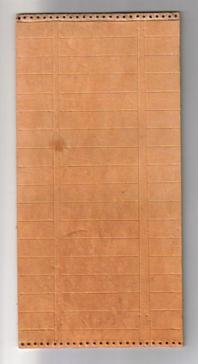

Howdy from South CarolinaWell I'm gonna try and make a little barrel. Got the idea when I knocked over my pencil cup for the 100 th time. It wont keep me from knocking over my pencil cup but at least it will look better than the mason jar I have them in now. If it turns out that is.Tom

Looks like a good start. If I may suggest, you can make 'rivet holes' by using a stylus ( or any pointy object) to press them in. Check out the wood grain patterns shown by Spider on his wallets.

Howdy Tom, I've got it stitched together and some what shaped. And yes I am going to try the wet molding. I'm thinking it might be easier to rough shape it before sewing it. This is just a proto type. I need the practice. On everything. But it's looking good so far. I'll try and take a photo of so you can see where I'm at so far. All I have is a cheap 50 dollar Radio Shack camera but I'll try.

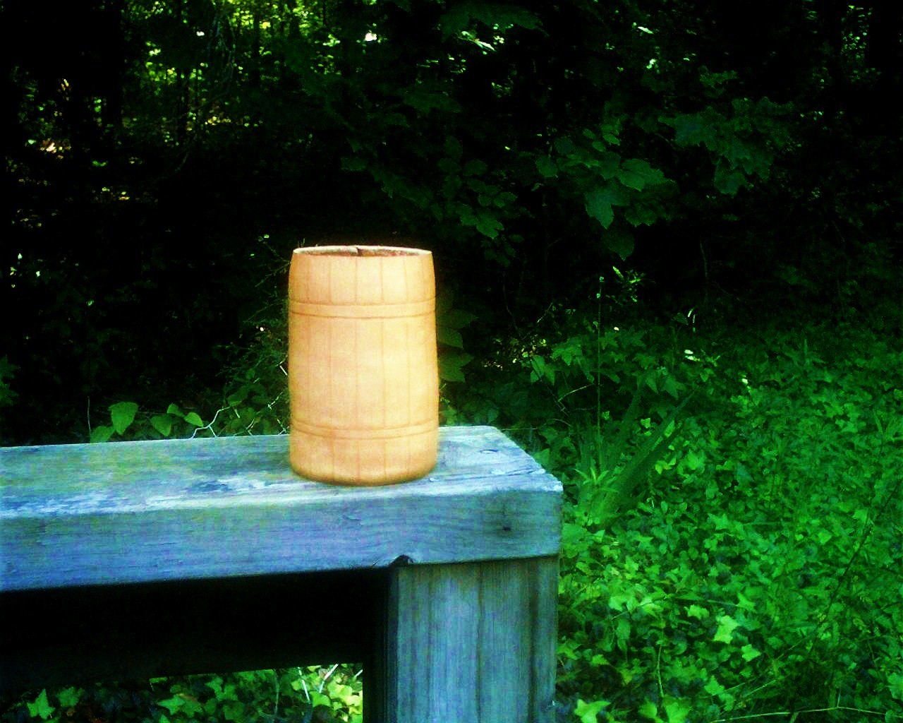

Well this is what I have so far. The shape isn't quite right yet. I have an idea though. I'm gonna go to the hardware store and get a plumbing plug. The kind you put in PVC then tighten. It's made of rubber so I'm thinking As it tightens it'll stretch the middle of the barrel. Wish me luch. Hope I dont rip the stitchs out.

That turned out really great
I'm not happy at all with the wat it turned out.
But rest assured I wont stop till I have made a better barrel. A better barrel is a happy barrel.
Tom
Artists are always our own worst critics....
I think that look great. nice work
That's a great idea and i think it looks great as well. I just might have to make one of those.
The plug is a nice touch !!
I think it turned out great as well. Very cool idea!
and I agree with Freak...
I can see what you're not happy about but it really is a nice barrel anyway.
I was thinking a small inflatable ball could work for the molding. Just put it in empty, inflate to desired bulge of the barrel is achieved and then deflate but I don't know where to get small balls with working inflate mechanism but it should work with a good pump.
Overall look is really nice anyway and the plug is a nice touch too. Woodgrain looks good so you got your practice done allright.

Hey Tom,
This is a cool concept. Remember that you have to separate the planks with deeper cuts and the grain with lighter cuts or as someone mentioned use the modeling spoon for the grain impressions.
I put the wood texture on tons of sh...stuff so it gives me great practice.
Turn an oval on your lathe (all leather workers have a wood lathe ...right )
then quarter it length ways. Slip it in your barrel then drive in three wedges
to push it out to the size you want. If you do not have a lathe to turn the
oval , I am sure you can take a large dowel of appropriate size and build
up the middle to make it oval using leather. If you have no large dowels
find a baseball bat that is the size you need. If all else fails make your
oval form from clay or some other suitable material you have laying around.

Nope, no lathe, So I'm making a mold by hand. I glued some 1 by 4 s together and now am in the process of planing and sanding it into the shape of a barrel.
