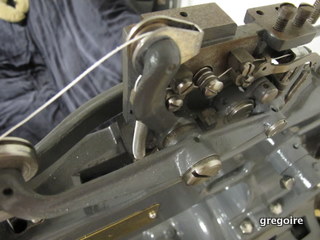

Members gregoire Posted May 3, 2011 Author Members Report Posted May 3, 2011 Hi gregoire, glad to have you join us! I don't have this particular machine, but I'm pretty sure there are at least a few people here who do and can help you. I think that will make it a little easier for someone to help you if you could be a little more specific about what you're trying to do, and what kind of problem you're running into. Kate Kate, Thank you! I basically would need all the info I could get. From the set up, making sure I am threading the machine properly, to help adjusting tention to get a proper stitch. I have the machine set up and have tried to stitch some leather but the loops on the bottom are not getting tight and are getting stuck on the bobbin. I will try to take a few picture and attach them to this post. I am thinking of trying to hire someone locally (san Diego) to help me with the initial set up. v/r gregoire Quote

Members gregoire Posted May 5, 2011 Author Members Report Posted May 5, 2011 all, Thank you for your help here are some pictures, I hope it helps v/r Gregoire Quote

Members CampbellRandall Posted May 14, 2011 Members Report Posted May 14, 2011 Still no luck! Any help would be great! thank you Try threading the top thread under the first take-up roll and over the second. You have it over the first, therefore the machine will not pull enough thread, leaving the large loops. Quote
Members gregoire Posted May 14, 2011 Author Members Report Posted May 14, 2011 Try threading the top thread under the first take-up roll and over the second. You have it over the first, therefore the machine will not pull enough thread, leaving the large loops. Thank you. i did correct that a few days ago. It is a little better but I still have long loops in the bottom of the leather. Quote

Members bdt46 Posted July 28, 2011 Members Report Posted July 28, 2011 I can't really tell by your pictures what the problem is, but Campbell-Randall is right about the first take up roller needs to be threaded on the underside. There is no thread tension plates on a Landis 3. It looks like maybe your needle may not be releasing your top thread as the shuttle passes through the loop. It could be pulling the thread on down and breaking or cutting the thread. Could be the thread locks on the top side are wore out and are not locking the thread to keep it from pulling on down to the bottom side. The shuttle tension could be to tight and holding the thread down. You can loosen the shuttle tension by turning the small screw on the side of the shuttle. Turn it counterclock wise a small bit at a time, carefully! Just a small amount of turn and then try a stitch or two to see if it is helping. Also the bobbin MUST be threaded in straight layers to function properly. Also some machines have a little trouble with the last 1/3 of the thread on the bobbin. Get you a book for the 3 and read all of it and it will help you immensely. Also Campbell-Randall handles some parts for your machine and if you will call them they can talk you through this a lot better than me! I personally have a Landis #1, Landis #3, and a Landis #16, and they are all great old machines. Some parts can be a real problem, and it helps to have a machinist friend! LOL But if you get the old machine going you will be surprised at the pretty stitch it will make, and no threaded needle machine can compare onthick leather items! Quote
Members gregoire Posted July 28, 2011 Author Members Report Posted July 28, 2011 Thank you all. First problem is my bobbin is not threaded properly. It s not properly done in straight layers. I did find a book but it has part numbers and treading sequence by part numbers. might as well be in chinese. I will work on it in the next couple days and take better pictures. Again thank you to all for your help! v/r Quote
