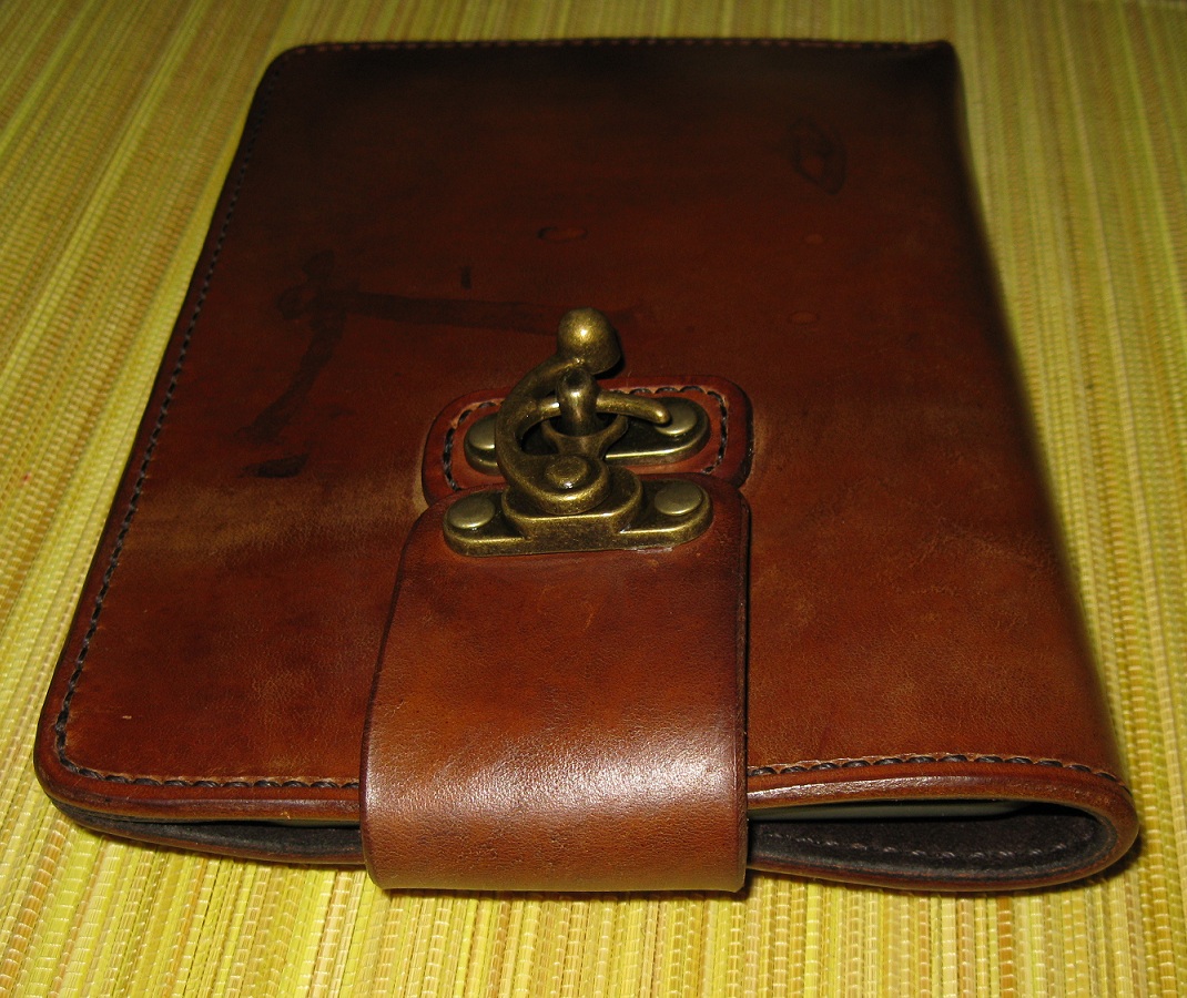

I dont know about the thinner leathers but when I make things like rifle slings and what not I use 8oz body and suede splits for the shoulder padding that is about 4oz. This I run right to the edge and stitch about 3/16 in back from the edge. I then bevel the edges on both sides. This usually cuts the suede at a rounded angle back away from the leather. I then burnish like normal and the edge of the suede smooths out along with the edge of the leather it is glued to. Looks pretty good IMHO but not sure on longevity of the edge.
I will try to find one of my older pictures to show you what it looks like.
EDIT: here is a kindle cover I made that shows what I am talking about. I did this pretty much the same way. It is horse hide with suede lining.

Thanks for those replies guys
Art - I considered a rolled edge, but really prefer the look of burnished for this project
Max, thats exactly the info I was looking for, and the picture helped heaps..
Cheers
Natalie
