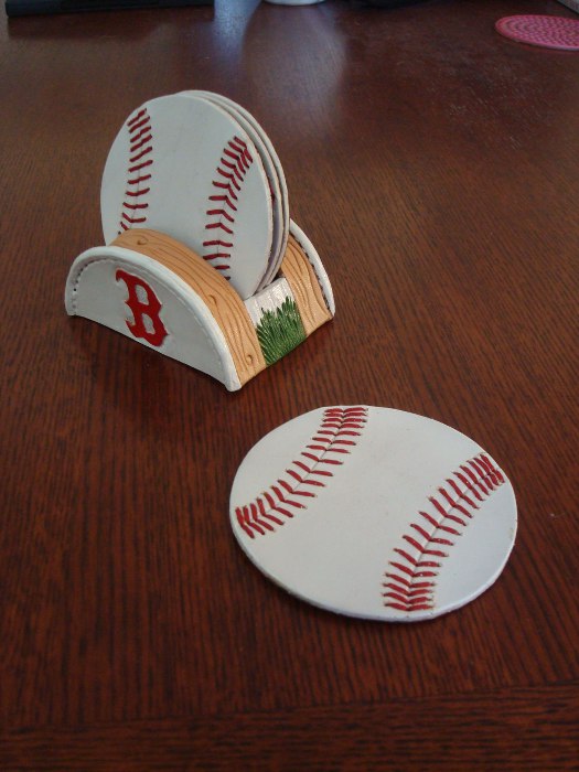

Here are a couple of examples of the white and grey on a few pieces I have done. The white and grey in both were applied with an inexpensive airbrush.
