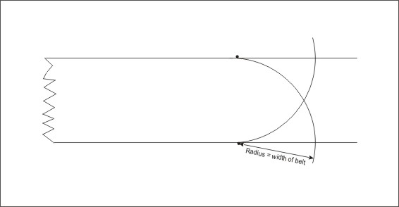

Members celticleather Posted August 16, 2011 Members Report Posted August 16, 2011 I am certain a French Curve would accomplish what you want to do. Or not. A French curve to make an English point? Could create an International Incident! Here's the traditional way to make an English point: 1 Set dividers to the width of the belt. 2 With the divider point close beside the belt, scribe an arc. 3 Place the divider point opposite the first centre-point, and scribe a second arc. The intersection of the two arcs is the English point. This method could also be used to make a template. Much cheaper than a strap punch!

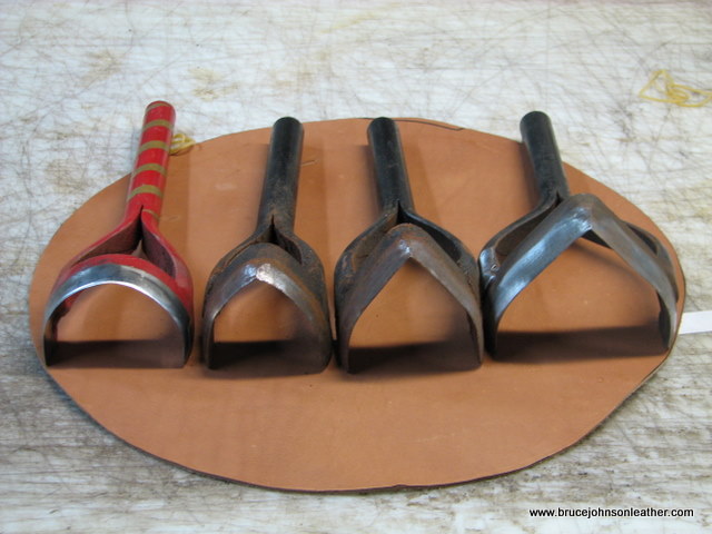

Moderator bruce johnson Posted August 16, 2011 Moderator Report Posted August 16, 2011 I learned the same trick Art did, but from an old guy. Until I got a decent set of smaller end punches I did that on everything. A couple years ago a buddy made me up a 2-1/2" round end to do the cutout above the rigging plates on a flat plate rigging. Last year he was messing around in the shop and made me up some point punches in 2", 2-1/2" and 3". The 2" is an English point and the larger ones have more point to them. I use the 2" on wider back billets and the bigger ones on leathers. They are great for shortening stirrup leathers on the saddle and getting the ends right the first time. I usually nip the very tip off straight across once it is punched to length.
