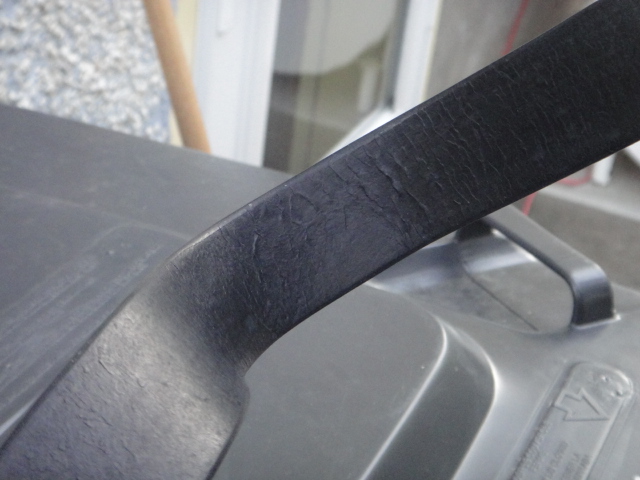

Hi Skald,
gum tragacanth works very well for slicking down the flesh side and for doing edges, but if you bend the leather some cracking will sometimes show up. If you want to test it, just go to a store that sells cake making supplies. It's used for stiffening up the icing on cakes (I'm having second thoughts about eating cake now) It can be bought in powder form, so no problem with the freezing.

post-14483-098041000 1313075271_thumb.jp

Further on, I don't mind some "cracking" of the burnished surface, especially on stress points, I guess we can call it "character" or "patina".
