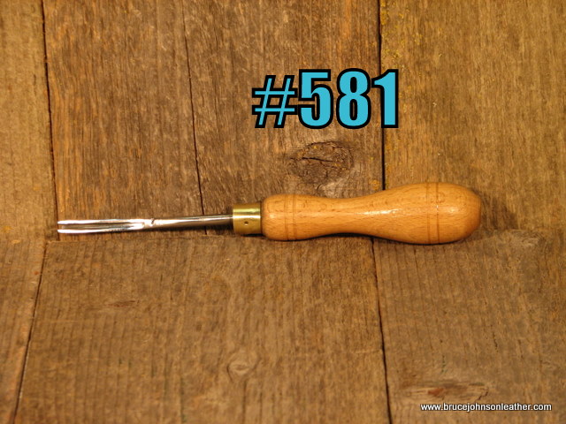

Stitching Pony Report post Posted September 2, 2011 Hi All How can I sharpen my new Dixon Edge Shave? I have just purchased 2 brand new Dixon Edge Shaves a #2 and #3. Trouble is they are both blunt and just chew the edge, can anyone tell me how to sharpen them or should I take them to a professional knife sharpener? I have had to go back to using my cheap #2 edge beveller which I have never sharpened and actually does a pretty good job. I have also noticed that my cheap edge beveller has a very distinct section cut out at the tip whereas the Dixon edge shavers have only a slight dent in the edge of the tip. Is this right or are they faulty? I bought the Dixons because I thought they would do a better job of the edge shaving, I'm beginning to think I've wasted my money. Any thoughts would be greatly appreciated Quote Share this post Link to post Share on other sites
gringobill Report post Posted September 2, 2011 Hi All How can I sharpen my new Dixon Edge Shave? I have just purchased 2 brand new Dixon Edge Shaves a #2 and #3. Trouble is they are both blunt and just chew the edge, can anyone tell me how to sharpen them or should I take them to a professional knife sharpener? I have had to go back to using my cheap #2 edge beveller which I have never sharpened and actually does a pretty good job. I have also noticed that my cheap edge beveller has a very distinct section cut out at the tip whereas the Dixon edge shavers have only a slight dent in the edge of the tip. Is this right or are they faulty? I bought the Dixons because I thought they would do a better job of the edge shaving, I'm beginning to think I've wasted my money. Any thoughts would be greatly appreciated Dangit!!!! That's a bummer, I'd be mighty dissappointed if I were you. Most high end edgers (I would consider Dixons to be that,) come really sharp and ready to use. You've got yourself a dilema here! From your discription is sounds like those tools need some shaping before sharpening. From what I expect those tools cost that should not be the case. I don't know how you bought your edgers, direct from Dixon or from a dealer? I think the first thing to try is to contact Dixon direct or the dealer and ask them for help. If that fails then it's on to plans B, C, etc. There is shaping and rough sharpening and then there is the finishing up more like stropping. Shaping the tools requires some skill and you sure don't want to ruin them. Personally I'd be really wary of letting a knife sharpener who isn't familiar with leather tools attempt to sharpen them. They are somewhat precision tools and the groove in the bottom need to be pretty precise. I have no idea of how confident you are in your own sharpening skills, if you are pretty skilled at that you can probably do the job, but if you're in doubt you probably should seek some professional help. Some saddlemakers sharpen edgers on the sharp edge of a good stone. Or there are slip stones which are shaped with a sharp edge. Woodcarvers use them to sharpen the inside of gouges. I think the most common method used on most better quality edgers is to get a round metal rod that fits the bottom contour of the tool. With the rod flat on a hard surface, put a piece of wet or dry sandpaper over the rod then pull the tool towards yourself on the paper. If these tools need a lot of material removed (and it sounds like they do,) you could start out with a course grit and work your way down to some very fine grit like 1500 or 2000 to get a fine finish. You can also put what ever you compound you use to strop your other blades on the sharp corner of a piece of thick skirting leather and strop the groove of the edger on that. You can do the same thing with a piece of heavy cord charged with your stropping compound. Another method which is more high tech and requires some care and skill is to use an small rubber grit impregnated wheel ( a good hobby store should have some in different grits,)in a rotary tool like a Dremel or Foredom Flex Shaft. You need to make sure the wheel is spinnind toward the tool tip and not toward the handle. All of this stuff probably means you spending more money so.....this is probably not what you want to hear, but I believe if you can get your money back you'd be better off to do that and spend it on some Ron's Tools or Barry King edgers. I have some of both and both are of incredibly high quality and come very sharp. Another possibillity would be to find a saddlemaker or other professional leather worker , if there is one in your area, and ask them for help in sharpening. I feel you pain, good luck! Bill Quote Share this post Link to post Share on other sites
bruce johnson Report post Posted September 2, 2011 Does it look like the one I have attached? They make a flat bottom version and a hollow ground which has a rounded bottom. If it is the flat bottom then the sharpening is pretty straightforward. You sharpen them on a fine stone from the bottom until you get to a fine foil edge. Then strop if lightly from both sides to remove that foil edge. Biggest thing is to make sure you get all of the foil stropped off. For the round bottoms, do like Bill suggested and use a round base like a nail or screwdriver and wrap it with the wet-dry sandpaper. Make sure the radius matches the tool. If there are grit marks when you are finished then go to finer stone or wet-dry sandpaper and do it again until the grit marks are gone. You can strop the slot out with a thin piece of leather or the edge of a piece of cardboard from the back of writing pad works. I use green compound. I would not toss the Dixon's, I have a some Dixons I have kept and the steel is pretty good. The shorter toes are easier to do inside curves with. Pretty nice tools overall. Quote Share this post Link to post Share on other sites

bruce johnson Report post Posted September 3, 2011 They look just like the one I have for sale. As far as the tip profile, that is how they are. They may not come deadly sharp from the factory, so a replacement may not be any better. I don't know to what degree of sharpness Dixon goes with their new tools. Some of the old line companies did not put a final edge on cutting tools. I have not had a new Dixon so can't say. I have pulled old Osborne tools out of the paper that hand no real edge. Older guys have told me that was to put your own favored final edge profile on. I got a pretty old Dixon plough gauge knife last year with the blade having a profile somewhat but a square edge on the front - it is my most reached for user. Pretty much most tools you get are not going to be using-sharp out of the box. For new edgers, Bob Douglas and Barry Kings should be. I don't know about Ron's edgers since he sold the business. although we expect to get sharp ready to use tools when we buy them new, they mostly aren't. If they are, we are generally paying the price for the maker to do that. In some cases that doesn't mean the tool is bad - just that it takes a little time to finish it off and make it good. Sharpening up that edger might take 10 minutes. In the process you will get a feel for how hard that steel is and what you can expect out of the tool. Even the ones coming sharp will need to be worked on every so often. Quote Share this post Link to post Share on other sites
