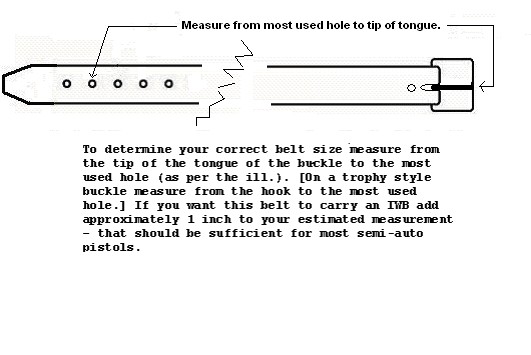

Billsotx Posted September 23, 2011 Report Posted September 23, 2011 (edited) Measure an old belt if you can. If you measure a person's waist put the tape or a string that won't stretch through the trouser's loops and pull the slack out of it, but don't pull it tight - that's the waist size the distance from the tip of the buckle's tongue to the center hole you're going to punch. Maybe the pix will help. Edited September 23, 2011 by Billsotx Quote
