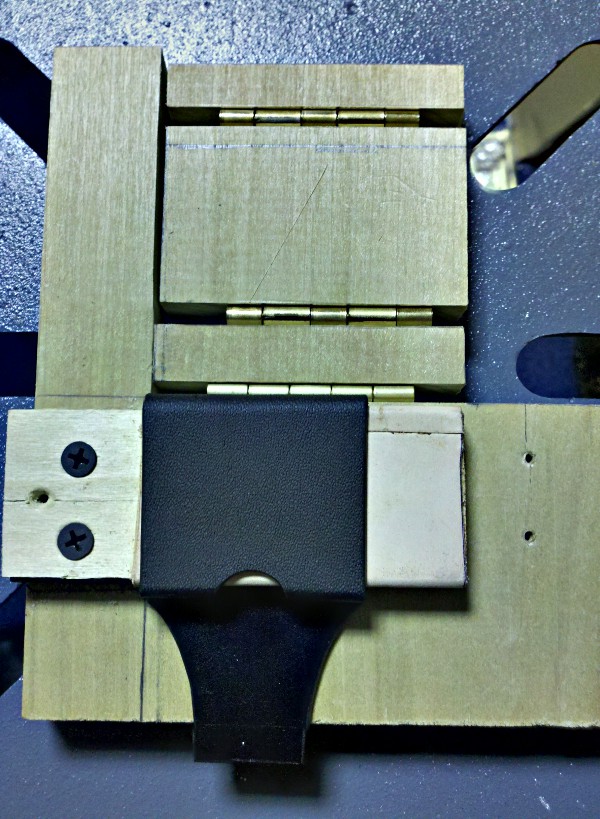

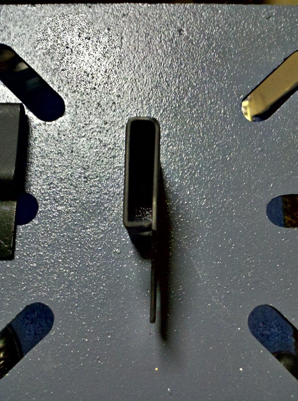

Members JoelR Posted October 17, 2011 Author Members Report Posted October 17, 2011 Here's the resulting first clip for a tuckable PF9 holster I am working on. The clip measures 2" wide for reference. And here is the clip in the jig. Quote By the end of the show you start telling them you keep a few head of steers behind the house and go out and carve off a strip when you need it, it grows back in 5 or 6 weeks. - Art JR
Members Nooj Posted October 19, 2011 Members Report Posted October 19, 2011 Hey- cool jig! I bet it makes short work of the forming part. What thickness kydex are you using, and how sturdy is it? Thanks for sharing the pics. Nooj Quote
Members JoelR Posted October 19, 2011 Author Members Report Posted October 19, 2011 Yes, much better than heat - bend - cool - heat - bend - cool - heat - bend - cool. Simply heat the top 2.5" of the Kydex strip, line it up in the jig, fold it up and hold it closed for about a minute to cool. Next version will be more accurate, add a better back-bend to the end of the clip, have a swing-away core for easier Kydex positioning, have a properly sized core (hence the reason this first run has a leather-wrapped core), and possibly add the ability to do "C" clips and quick-release style clips. The Kydex is .093" in thickness and can be bought at Springfield Leather. For the indended use, it is more than adequate but I would probably bump up to the next thickness if I needed to make "C" clips or "J" clips. Quote By the end of the show you start telling them you keep a few head of steers behind the house and go out and carve off a strip when you need it, it grows back in 5 or 6 weeks. - Art JR
