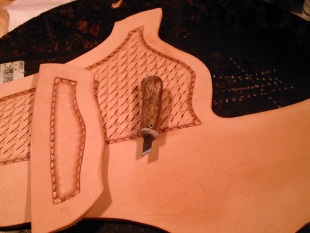

Members DCKNIVES Posted August 11, 2008 Members Report Posted August 11, 2008 This is a punching setup I built for my drill press.The table is made from aluminum and covered with UHMW a very slick plastic. I used boards with notches(for the belt loops) to punch on and the plastic allows for easy movement. I punch using various size drill bits with sharpened shanks and the drill press running. I modified this arbor press for putting my makers mark on my knives and sheaths. I just milled a slot in the ram and tapped a couple of holes for set screws. My mentor and friend Sandy Morrissey made this stamp for me while showing me his technique for tooling faux snakeskin inlays. This is a sheath done using this stamp and technique Hope you like everything.Dave Quote http://dcknivesandle...lademakers.com/
Members charley Posted August 12, 2008 Members Report Posted August 12, 2008 My mentor and friend Sandy Morrissey made this stamp for me while showing me his technique for tooling faux snakeskin inlays.<snip> Hope you like everything.Dave Can you show a close-up of the impression from that stamp? Or a higher res image for the sheath? It looks really good... --charley Quote
Members DCKNIVES Posted August 12, 2008 Members Report Posted August 12, 2008 Charley, looked to see if I had anything closer.Try this, a little better to see.Dave Quote http://dcknivesandle...lademakers.com/
Members HandyAndy Posted August 12, 2008 Author Members Report Posted August 12, 2008 Wow! I'm totally making one of those snake scale stamps! Quote
Members cybertracy Posted August 12, 2008 Members Report Posted August 12, 2008 [ My mentor and friend Sandy Morrissey made this stamp for me while showing me his technique for tooling faux snakeskin inlays. Dave, was the snakeskin stamp made from scratch or modified from another stamp? Awesome effect! Quote [color="#FF8C00"][size="4"][font="Tahoma"][size="5"][i]wag[/i] more,[/size][size="3"] bark less . . . [/size] happy tails, tracy[/font][/size][/color]
