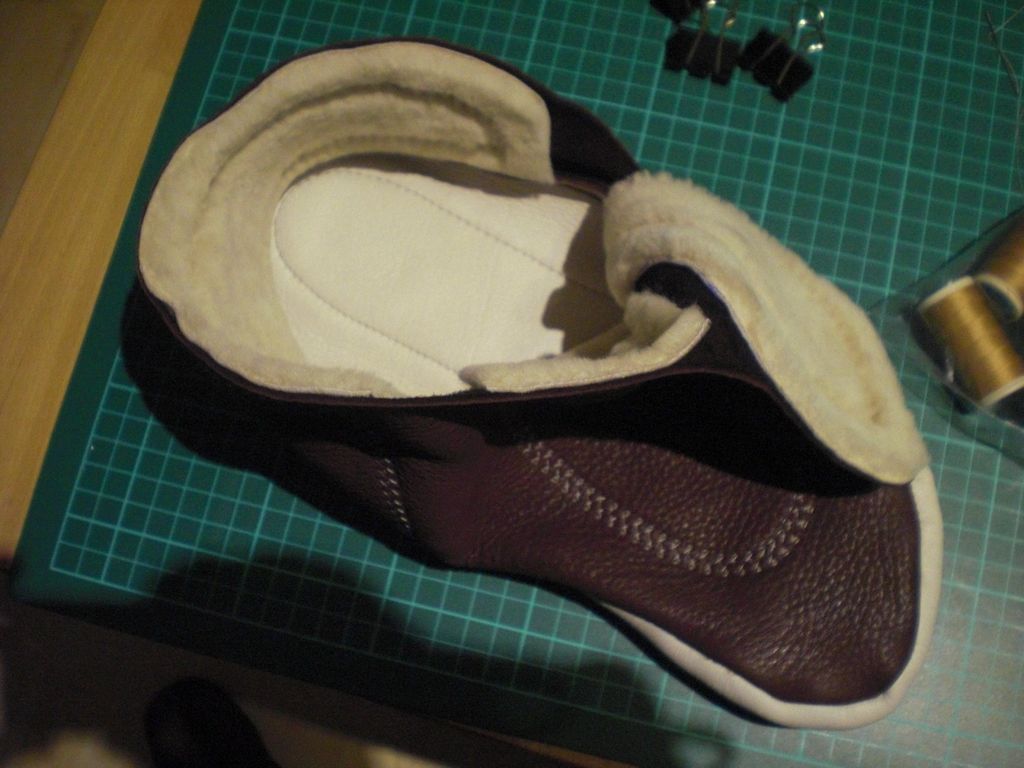

Members Suicide Posted November 24, 2011 Members Report Posted November 24, 2011 Hi everybody Can somebody please give ma any ideas on how do they sew the sole on the Pueblo moccasins? I tried hard but see no any stitches on it. Is it kinda tunnel stitch or what? It is also interesting for me how they preform the sole (I know it should be formed wet as it is seem latigo, but exact process currently unknown for me). I would very appreciate for any links or might be books / excerpts on that technique. Please Quote
Moderator Art Posted November 24, 2011 Moderator Report Posted November 24, 2011 Hard to tell from the picture. Glue is an option instead of sewing. The easiest way is to use the turnshoe type of structure where you sew them inside out then when finished "turn" the shoe rightside out for a nice looking seam. There is also a method where you sew the outsole to the insole right up through the inside of the shoe, this could, of course, be done on the side of the shoe in the same manner. You could use either a chain stitch or a lock stitch to accomplish this. I have a chain stitch machine that was once used for exactly that. Everyone worries about the chain stitch coming apart, but with the right wax those things are in there to stay. Best talk to one of the true moc makers on here for the answer. Let them eat their bird first. Art Hi everybody Can somebody please give ma any ideas on how do they sew the sole on the Pueblo moccasins? I tried hard but see no any stitches on it. Is it kinda tunnel stitch or what? It is also interesting for me how they preform the sole (I know it should be formed wet as it is seem latigo, but exact process currently unknown for me). I would very appreciate for any links or might be books / excerpts on that technique. Please Quote
Members Suicide Posted November 25, 2011 Author Members Report Posted November 25, 2011 Hard to tell from the picture. Glue is an option instead of sewing. Hi Art, They aren't glued 100%, most likely your right and they had been sewn wrong side out. Here I attached another example - it seems like stitch is there, but again, I can't see any threads, just creases on the white sole like it has been stitched. Another source They also claimed as sewed not glued. Quote
Members steve hansl Posted November 25, 2011 Members Report Posted November 25, 2011 The soles look like they are made of crepe rubber to me,probably preformed soles. Quote

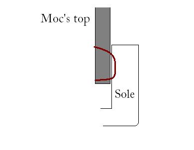

Members Suicide Posted November 25, 2011 Author Members Report Posted November 25, 2011 The soles look like they are made of crepe rubber to me,probably preformed soles. To me too, but they said this is latigo. And they insist there is no glue used but handsewing only. Thats kind of mystery for me unless they sew it in the way like I drew on the picture attached. Quote
Members gunter Posted November 25, 2011 Members Report Posted November 25, 2011 fellow crafters, the soles of the navajo mocs or better known as kaibab, normaly and tradinionaly are made from a thick white rawhide. This rawhide is 1 inch to 1 1/2 larger as your foot, when you are makeing a pattern. I find the best way to make these kaibabsole to make little holes on the upperside of the soles before you make them wet and form them. This is I how made them and will continue to make them. I also posted a sort of pattern on how to make them somewhere on the forum. So if you putt out a search for navajo moc or kaibab, you should find the way how to make them ;-). cheers, Gunter Quote

Members Suicide Posted November 27, 2011 Author Members Report Posted November 27, 2011 Somehow got over it with soft double (actually - "triple" ) sole. Thanks everybody for help and ideas! Quote
