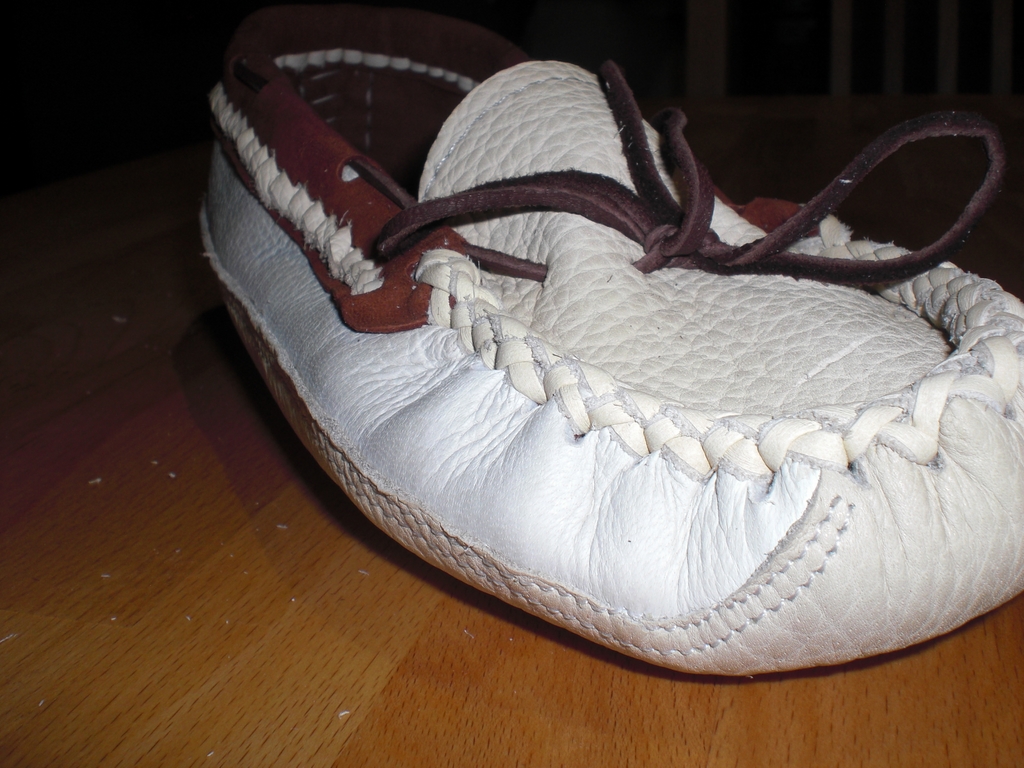

Members Suicide Posted January 2, 2012 Author Members Report Posted January 2, 2012 (edited) On 1/2/2012 at 3:28 PM, Dwing8 said: Can't hardly wait to see it! BTW here is my previous pair done. they have just gathered toe with no pleats but also finished with round mexican braid. Edited January 2, 2012 by Suicide Quote My leatherwork gallery
Members Dwing8 Posted January 2, 2012 Members Report Posted January 2, 2012 Thanks for posting those pics, now I'm anxious to see the new ones. The first ones looked great! Dano Quote
