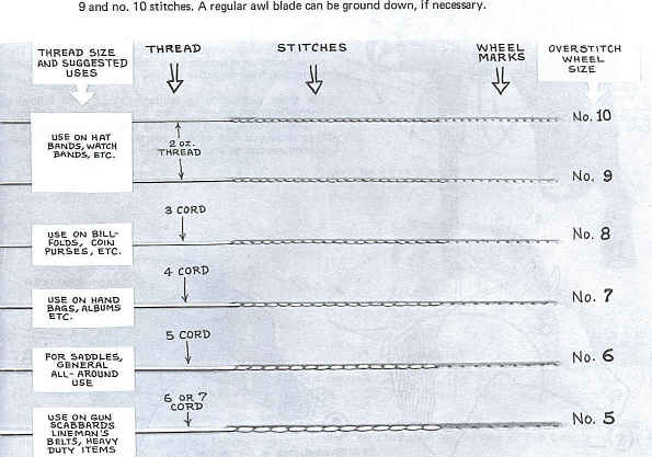

A rule of thumb for gauging distance is the same distance from the edge as the total thickness of the leathers to be sewn.
This may help ...
post-19342-057277900 1326335242_thumb.jp
This may help ...
thanks for the reply.
that gives me a starting point to work from.
appreciate your help.
ron
