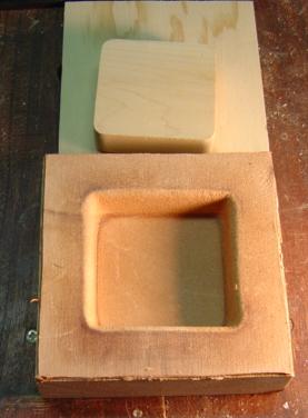

Can you tell me how you formed that compass pouch?

I formed the damp leather around a wood block that I made on a table router. It took quite a bit of poking and proding with my fingers to get the leather wrapped around the corners nicely. Then I cut out a cavity into a piece of foam I had laying around and set it on top to hold the shape till it dried a bit. This was my first attempt at formed leather, and I was quite happy with how it turned out. Here are a few more pics if you're interested.

I'll have to router out a piece of cedar, make a matching insert for it minus the thickness of leather, put the leather in the cut out portion, place the matching block on top then clamp the two together.
I think it might work.

Well, I got half the form made today and I'll try and make the other half tomorrow.

I'll get the leather and the insert together and then put the entire thing in a vise and let it dry.
It should work.

Just don't leave it too long, I had the foam over the top of mine for less than 24 hrs and it was already starting to grow some mildew on the wood.
I have the leather in the form now and I'll check it after six hours and we'll see what we have.
Well, six hours is up.
I would have to say that turned out pretty good! I also like the wood grain stamped into the leather. Gives me lots of idears...
I have to say I am happy with the results.
It was like baking a cake, just sit back and let it happen.
You can even drop or glue a design in the bottom and let the leather pick it up.
It was easy to trim and once it completely dries I'll sand it closer to the edge.

Sweet. I personally wouldn't trim it much more until after the stitching. I glued mine to the back piece before I punched the holes and stitched it, so the extra material around the edge gave me something to glue up. After I stitched mine, I trimmed it up and ran the edges over a belt sander to even-up the two layers and smooth them out before using an edge beveller to round the corners a bit.
There's always more than one way to skin a cat, but this is what worked for me. Good luck!
