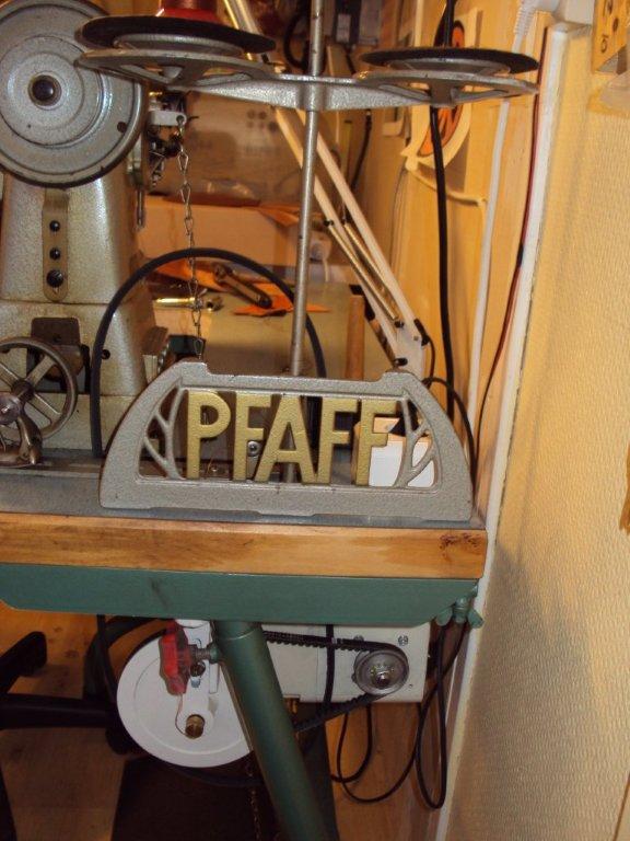

I just purchased a second hand Pfaff 345- H3-6C-LN
I want to set up this machine for leather binding, and the best will be a synchronized leather binder.
So far I spend 271 $ for the machine. (It was a bargain)
250 $ for a Cobra servomotor and a speed reducer.
Some hours work, (cleaning, building and adjusting)

My friend the Leather Guru told me to do the work by hand, but the must be an alternative to the original parts.
This is a very common type of cylinder bed machine; I have seen many Chinese machines with the same arm. There must be a more reasonable priced option out there.
Maybe some of our machine dealers have something for sale.
