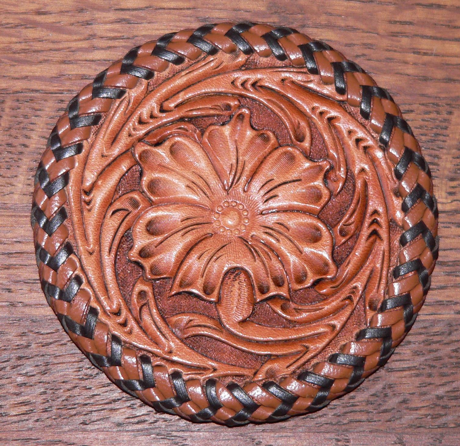

electrathon Posted February 6, 2012 Report Posted February 6, 2012 The dark backgrounding is done with dye, likely painted in with a brush. If I were doing the project I would first finish with a coat of neet-laq. Then apply antique paste. Finally a coat of tan-kote. The attached coaster was done with this process. As a warning, if you do not put a finish on before you antique, it will look like you drug it in the mud. Aaron Quote

electrathon Posted February 6, 2012 Report Posted February 6, 2012 The trouble you are having with the antique making spots in the middle areas is the evidence that you did not properly seal it up. When I neet-laq I put it on with a piece of sheep wool. I put on a medium heavy coat and smear it all over. Then take a dry piece and try to wipe any excess off. Rub gently in all directions around the tooling to lift off any ponding. You only have a minute or two to do this. When dry (overnight) you can then antique. I only use Fiebings paste. I usually will not do the entire thing just in case. Wipe it on (wool again) and then dry wipe it off (clean wool). After you have it wiped to the level you want (you can control how much you want to leave) then do the process again with Tan Kote. The Tan Kote will lift off any stains left on the flat areas. Let it dry. On a different issue: Keep the antique away from those holes! It will make a mess of the lace if you don't. Aaron Quote
