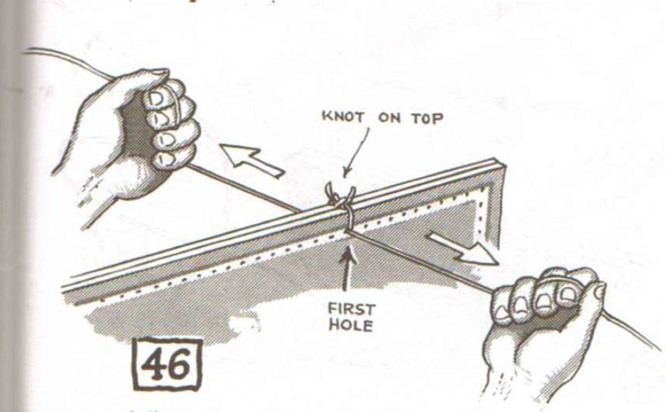

Members ChuckBurrows Posted April 24, 2012 Members Report Posted April 24, 2012 one last note - when using linen NO knots - backstitch instead - a little trick - with 5 cord I use #1 or #2 Osborne egg eye harness needles depednent on stitch length - #1 is a bit harder to thread but I use it for 8 SPI for 5 or 6 SPI the #2 is a bit bigger and is a bit easier to htread and use. When backstitchin i is sometimes tough to pull the needle through without pliers which I don't like to use except when necessary - so anyway I made up an "awl" with a 00 size harness needle and use that to open up the hole a bit for back stitching - this wya it just stretches it a bit and won't cut your thread like a regular awl will. You can see the needle awl here it's the antler handled one just to the right of the pony - the otehr two are my hand awl (red handle) and the one on the left is for using with a mallet: Quote

Members ChuckBurrows Posted May 15, 2012 Members Report Posted May 15, 2012 IMO anyone interested in handsewing leather should get a copy of Al Stohlman's book "The Art of Handsewing Leather". It shows you much more than justt he basics including how us old timers made up (and still do at times) different cord threads starting with a single cord.. Even after 51 years of sewing leather by hand I leaf through it. Quote
