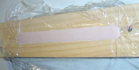

Here's another method for molding wet leather.
I'm using a molding putty, forming the mold in the first picture then removing it from that mold and baking it in the oven to harden it.

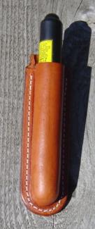

In the second picture the hard clay mold has been used to mold the leather.
This works really well for odd shapes.

Seriously Kevin, I can tell, do you already have a routed hole in this to put the putty to mold it to begin with? I'm a tad tired and very confused :-)
Hi Cheryl;
This is the mold I was telling you about for an epi pen but on a smaller scale, 3/4" in diameter.
I made the original (routed) wood mold for forming the leather slightly larger to accommodate 5oz. leather and then I made another (routed) wood mold 1/4" smaller to form the clay mold.
The smaller clay mold combined with 5 oz. leather fit perfectly inside the leather mold.
To stiffen the clay I wrapped four lengths of wire clothes hanger in foil tape and molded the clay around that.
This mold should last a long time and I'm able to make two cases at once if I cut the molded leather in half.
I'm very happy with this process.

I'm using a router to make the wooden molds but in your case where you don't have the router you could make a mold out of clay instead of wood then use that to form your leather.

For an 1 1/2" diameter epi pen you could form the clay around a piece of plastic pipe or bottle about 1 3/4"outside diameter then use a piece of 1 1/2" wood dowel to mold the wet leather.
You can do the same for pen cases, use wood dowels for your molding.

You can press a knife, lipstick tube or just about anything into the soft clay and make your mold then bake it.

This is the finished lighter case using the clay molding.

That's really cool Kevin. I' ve got to try some of this stuff, seriously. c
