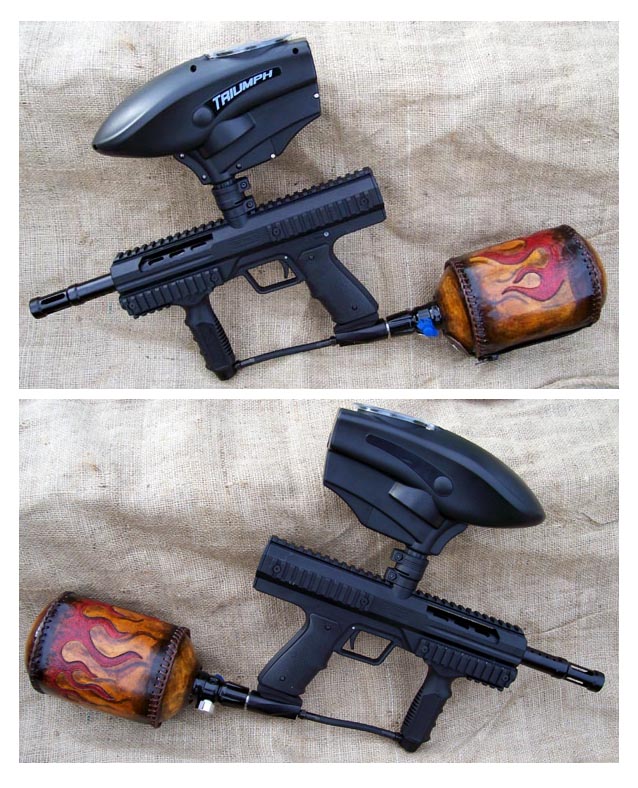

Here's the one i was working on while posting the prototype one. Not much on the creative side once it came to tooling a design. Just some very, very simple child like flames. Now i gotta get me some velcro and start the next one and do something about this freakin tooth ache. ARRGGGG !!!! freakin frattin no good tooth ....... ouch

Freak, I really like the aged look you're able to achieve. I keep trying to do this with not much success so far. Did you use Eco-Flo dyes, and if so, which ones? Also, how did you apply them... With a dauber?
Any tips would be appreciated, my friend! Best, -Alex :cowboy:

Alex, Yes i'm using eco flo dyes. Here's what i'm doing.
I first applied the "range tan" with a dauber, everywhere. Then i used "java brown", which i applied with a brush. I colored all the places you would want antique to darken. I would lay it on a little heavy in those places and as the brush starts to dry i make very short strokes just where ever. Then i use "dr cocoa brown" on the edges. I apply it with a brush as well. I lay this on in many diff coats to achieve the dark shade i want. Just like the "java brown" when the brush starts to dry i blotch the brush to blend the edge color to the center . I also make some brush strokes here and there just like i did with the "java brown". Then i buff the carp out of it and seal with super sheen. That's when you can really see the aging look. Buff the carp out of that and apply one more coat of SS.
Hope that made since. I still need to make one more of these. I'll take pics as i go on the dye job.

I like that paint job - makes the flames look 3-D. And I say excellent work with the zipper.

Thank you. Now i gotta start laying out the next one which i'll try using velcro. Still drawing up my graphics for it. Here's a quick pic of the tank on the gun. Think i'll have to cover the hopper in leather to match (the big thing on top that holds the balls) and maybe a grip cover.
