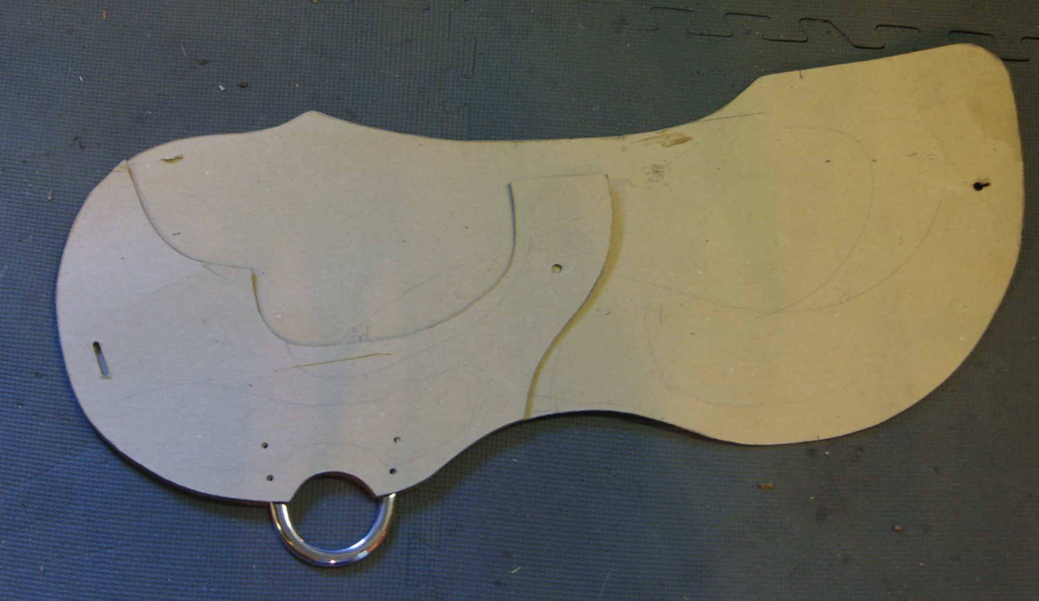

I build saddles for short persons quite regularly .I usually suggest an inskirt rigging . the fenders are cut to the needed . length with buckle set short to ensure that it will be below the rigging. The rigging is usually set as high as possible. I also suggest 1 /2 stirrup leathers. Also using light weight leather helps .a picture link

I would also suggest an inskirt rigging. Custom saddles today should be made to FIT you and your needs. The inskirt rigging is great for getting you close without the bulk. Again, just like Andy said. The half stirrup leather with also reduce bulk. One other thing I can suggest is, avoid tying a knot on the latigo, use the tounge (spelling?) on the cinch only.
Here's a picture of something I might first suggest. It may work the best, besides it's plenty strong for ranch work.

I make a lot of saddles for ladies who work cattle and ride long distances. Comfortable, narrow seats, good stirrup freedom and flexibility, correct horse fit are among the most important requirements. Also, light weight and relief for painless knees and ankles. At 5'7" you are not that short; how long is your inseam? What are your waist and hip measurements? You want a slick fork, how high cantle? At 127 lbs, a 15 1/2" seat will give you quite a bit of room for movement, especially with a flatter seat and 3 1/2" - 4" cantle. If you want a narrower seat, you need to add a bit more rise to the front of the seat. An in-skirt rigging will be the closest to your horse, as well as single stirrup leathers. The wrap on the fender tail does not need to be as long as what you have seen and can be made much shorter. You can also eliminate the buckle entirely and adjust the length at the top of the fender with either lace or a quick change buckle.
I can make you a saddle. I would need specific information detailing what you want in a saddle as well as info profiling your horses.

Just finished sewing a cantle binding on a ladies saddle.The main thing is get a good seat.Every one has covered the rest .I think a Skirt Rig is fine,But a plate or ring put in right should still be just as narrow.2.5" leathers would help with the bulk.
