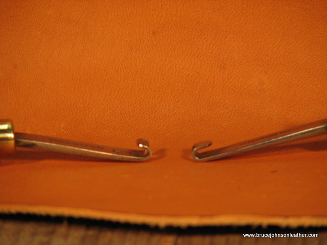

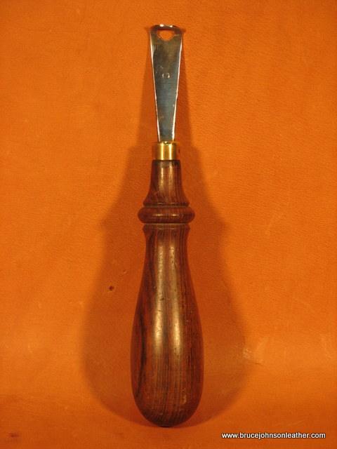

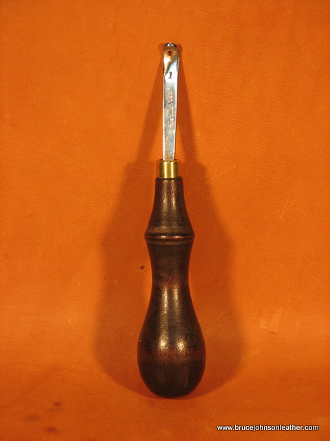

I am attaching pictures of a few types of edgers that will do a good job on slots. If they display in the order they load, I am good here. Not all bisonette edgers are made the same. The first picture is an older CS Osborne bisonette. It doesn't have a lot of bend at the cutting hole. It is great for running down a straight edge or gentle curve.l The leading edge of the hole will ride on the leather like a training wheel and the cutting angle is consistant. On tight inside curves though it can raise the cutting edge away from the leather. The second image is an old Rosecrans bisonette. They were made with a lot of bend at the hole. They will do a tight curve easily. The third image is a Gomph round bottom edger. With the open toe design, I can do most all inside curves pretty well and they sharpen up easily and have a ton of life to them. The next picture are two old Rosecrans turnback edgers. They are designed for the tight inside curves. They are basically a bisonette bent over almost double. I have a side view of these as well in the last picture. These are all older tools I have or used to have. There are a few who make versions of all of these new now - Bob Douglas has new ones he makes along with Barry King and Jeremiah Watt.
