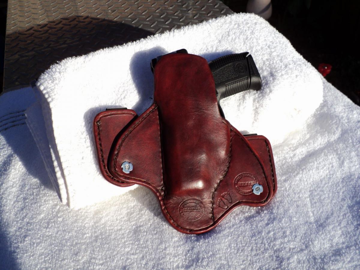

Members Ed in Tx Posted November 3, 2012 Members Report Posted November 3, 2012 Unless you are wanting an attachment that can swivel "Chicago Screws" are really the best for reinforcing a bond. The "T" nuts can be used for attaching a holster clip mount that will give you the ability to move it or swivel the location. I am attaching a picture of an IWB holster I make that uses "T" nuts so the mounts can be adjusted. Bottom line, if you just want to reinforce a seam use chicago screw. Quote
