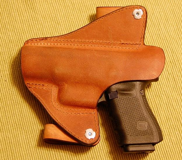

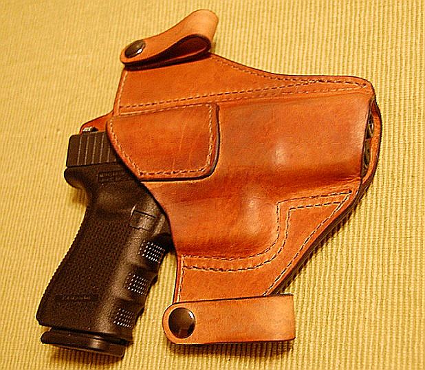

MADMAX22 Report post Posted November 3, 2012 Hey guys been a while since I have posted anything, been busy learning out how to make knives so only been doing leatherwork here and there for buddies. Finally had some time to do some holster orders. This is the first one Ive completed for the glock, and yes everyone is right the trigger gaurd is kind of a pain to get a good mold around. Anyways comments always welcome. I know the stitching didnt come out all that great. Keep forgetting if I cut the stitching channel the sewing machine will sinc the stitch too far in. Plus I am not quiet sure about the space between the grip and the top of the holster. It pulls fine but am thinking a little more space there would be nice. Quote Share this post Link to post Share on other sites
IngleGunLeather Report post Posted November 3, 2012 (edited) I think it looks really good. the stitches and the the stitch lines are evenly spaced. the edges look good. the only thing i'm gonna have to comment on is that i think there should be more space between the rear of the holster and the grip of the gun (maybe an extra 1/4"). Edited November 3, 2012 by CountryTrash Quote Share this post Link to post Share on other sites
MADMAX22 Report post Posted November 3, 2012 Thanks Country, I agree with ya. I am gonna try and adjust the pattern some to allow more space. I think your right about a 1/4" would be adequate. Quote Share this post Link to post Share on other sites
