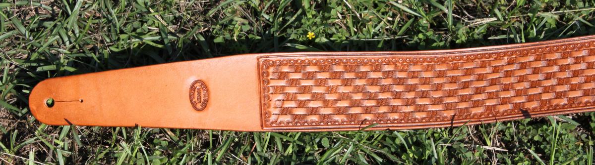

Members ProCreationz Posted November 25, 2012 Members Report Posted November 25, 2012 My first time with this basket weave tool. I like it and am looking forward to the next time I get an order to use it! Quote
Members Bluesman Posted November 25, 2012 Members Report Posted November 25, 2012 Great job on the weave. I also like BW stamps, they make such a cool design. Whomever you made the strap for is going to love it. Quote
Chief31794 Posted November 25, 2012 Report Posted November 25, 2012 Good job, I really like it. One note, I would take a 00 punch and end the slits on the attachment holes, that prevents them from splitting farther as the strap is used and put on and off several time. Have the slit end in the two holes, large one which you have at the bottom and a very small one at the top to act as a stop. Chief Quote
Jaymack Posted November 25, 2012 Report Posted November 25, 2012 Nice strap! It's my understanding that the tri-weave is the most difficult. The Harley and shotgun shell stamp really work with this! John Quote
Members ProCreationz Posted November 25, 2012 Author Members Report Posted November 25, 2012 Good job, I really like it. One note, I would take a 00 punch and end the slits on the attachment holes, that prevents them from splitting farther as the strap is used and put on and off several time. Have the slit end in the two holes, large one which you have at the bottom and a very small one at the top to act as a stop. Chief Thanks for the tip, Chief! Quote
Members ProCreationz Posted November 25, 2012 Author Members Report Posted November 25, 2012 Nice strap! It's my understanding that the tri-weave is the most difficult. The Harley and shotgun shell stamp really work with this! John Thanks, John. I did some practice with the tool some before I put it to the strap. It took just a few minutes to get used to the alignment, but the practice did help. It is a bit different than the other BW tools. The 3-D stamps did work well. I picked the brain of my client in order to select the right accent stamps that Guy would like. That shotgun shell came out nice with the small rivet in the center. Quote
