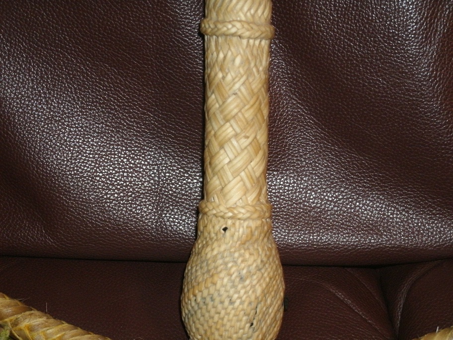

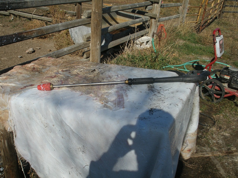

Members venthompson Posted November 29, 2012 Members Report Posted November 29, 2012 My first post and first braiding in 25 years. Just getting back into it. Pictures are of a fancy quirt made of Cowhide 16 plait with deer and elk fancy knots. The aussie style whip is 16 plait elk thong and a 48 plait deer covered hickory handle. also a picture of how I flesh hides with a pressure washer. Quote
Members megabit Posted November 29, 2012 Members Report Posted November 29, 2012 Doesn't look like you forgot anything. Very nice work. Quote
Members benlilly1 Posted November 29, 2012 Members Report Posted November 29, 2012 They look nice! Tedious work! Quote

Members Tanthathide9 Posted November 30, 2012 Members Report Posted November 30, 2012 At what pressure is ur pressure washer set to when ur defleshing, with a house full of little ones mama not so happy happy happy when dads out fleshing a hide Quote
Members venthompson Posted November 30, 2012 Author Members Report Posted November 30, 2012 It's 2500 psi pressure washer with a special rotating nozzel I picked up at Sears. It takes about 15 minutes to do a deer hide and about an hour for a cowhide to flesh. It makes a mess but I have plenty of room outside. It sure cleans the hide good though. Quote
