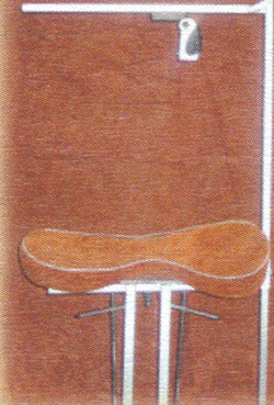

Members tnawrot2 Posted December 29, 2012 Members Report Posted December 29, 2012 Rob, Last May, at the Sheridan show, Pete Gorrell was using a laser that was mounted on a hydraulic saddle stand, I think it was made by Tom leather tools. The model of laser was.... Bushnell 82897 Pivot Point Laser Level there was a square bushing mounted to the stand and an "L" piece of 3/4" that slid into the bushing. The laser has a magnetic base that is put on the side of the "L" that is over the saddle. You should be able to buy the laser for about $30.00. Quote
Moderator bruce johnson Posted December 29, 2012 Moderator Report Posted December 29, 2012 I have one that mounts on my hydraulic stand from Ron's tools. It is just Ok to use. I could get by without it. It is a little unsteady and you bump the stand and the arm moves and you need to reset everything. Good for checking one though. Quote

Members tnawrot2 Posted December 29, 2012 Members Report Posted December 29, 2012 It was Ron's drawdown stand not Tom's. As long you put a metal plate on the ceiling, you can still use the Bushnell laser. Here is a picture of Tom's drawdown stand with the laser attached. Quote
Members Wy Josh Posted April 17, 2013 Members Report Posted April 17, 2013 That setup in Pete's class was from Ron's tools. Josh Quote
