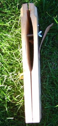

Tree Reaper Posted January 14, 2013 Report Posted January 14, 2013 This is what I clamp in my workmate and when I'm done stitching it gets put away, out of the way. Quote

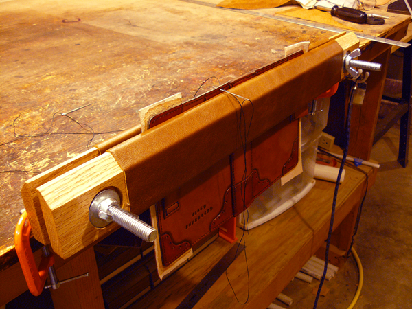

Members JustKate Posted January 15, 2013 Members Report Posted January 15, 2013 Here's one I designed a few years ago that's really easy to make. Quote My gallery My Facebook page My web site
Members Cyberthrasher Posted January 15, 2013 Members Report Posted January 15, 2013 Here's one I designed a few years ago that's really easy to make. Oh yeah, i saw that one a few days ago and forgot all about it. That would actually be more my style since I try to do all my work at my bench and prefer my bar stool. Quote hellhoundkustoms.wordpress.com www.facebook.com/hellhoundkustoms www.etsy.com/shop/HellhoundKustoms
Tree Reaper Posted January 16, 2013 Report Posted January 16, 2013 It doesn't get stuck on the wing nut because there's a leather strap over it when it's being used. The problem that I found with the pony you referred to in the prior post is that the thread WILL get stuck on that tightening knob, trust me! I am working on some new designs. Good luck with your endeavors! Quote
Members lightningad Posted January 16, 2013 Members Report Posted January 16, 2013 Here's one I designed a few years ago that's really easy to make. I think it looks great Kate, and i like the practicality of the long jaws, but it looks awkward to use because the leather is facing you rather than perpendicular to you. I find its much quicker if you can use both hands to pass the needles through and more accurate because you can put equal pressure on both sides of the saddle stitch. I saw a great looking clamp a few days ago - i'm going to have to try and make a version of this for myself... http://leatherworker.net/forum/index.php?showtopic=44874&st=15 halfway down the page Nigel has attached a saddlers clamp to a log - looks fantastic! adam Quote "You is what you am, a cow don't make ham!" Frank Zappa - Musical Visionary Barking Rooster Leather Goods Pinterest Page
