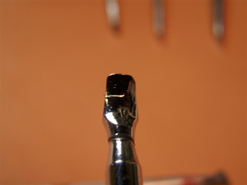

The first are Craftool undercut bevelers.
These have sort of a square end with rounded corners. They end is blunt and doesn't really cut into the leather. They come in two sizes and work best for striaght lines.

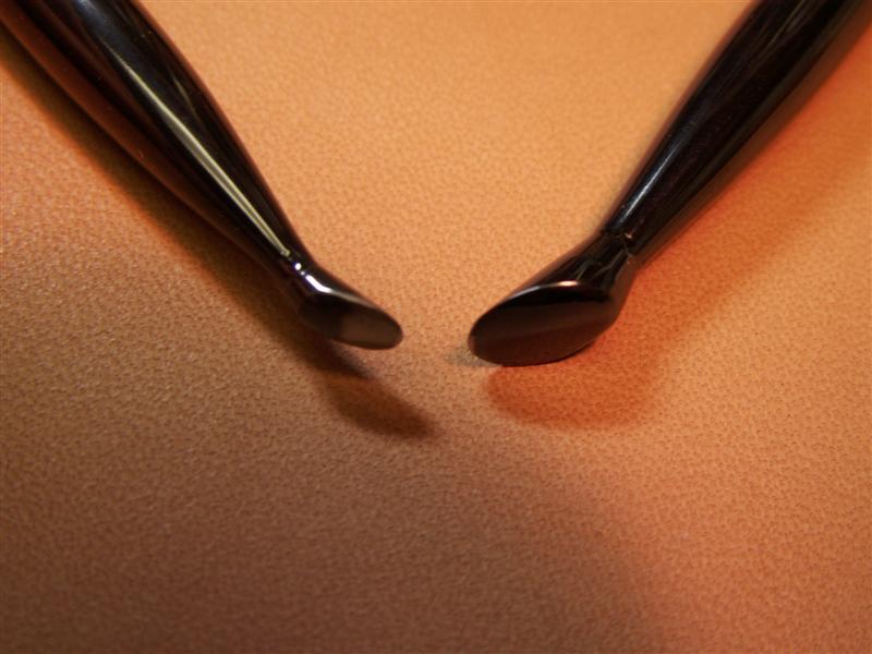

The next are Barry King petal lifters.
These have more of a rounded end and it is really blunt. I think the main use for them is on the inside curves on flower petals. It pushes the leather up in these areas and gives it sort of a ridge.

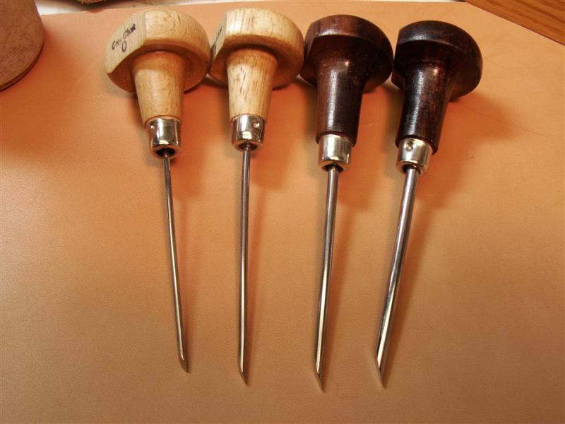

Then there are Jeff Mosby's pro petal tools. I have 4 sizes, he may have more. These are REALLY sharp! The will go into the leather as far as you want and when you lift up on them while they are in the leather, you can get a really nice ridge. undercuts_001__Medium_.jpgundercuts_002__Medium_.jpg

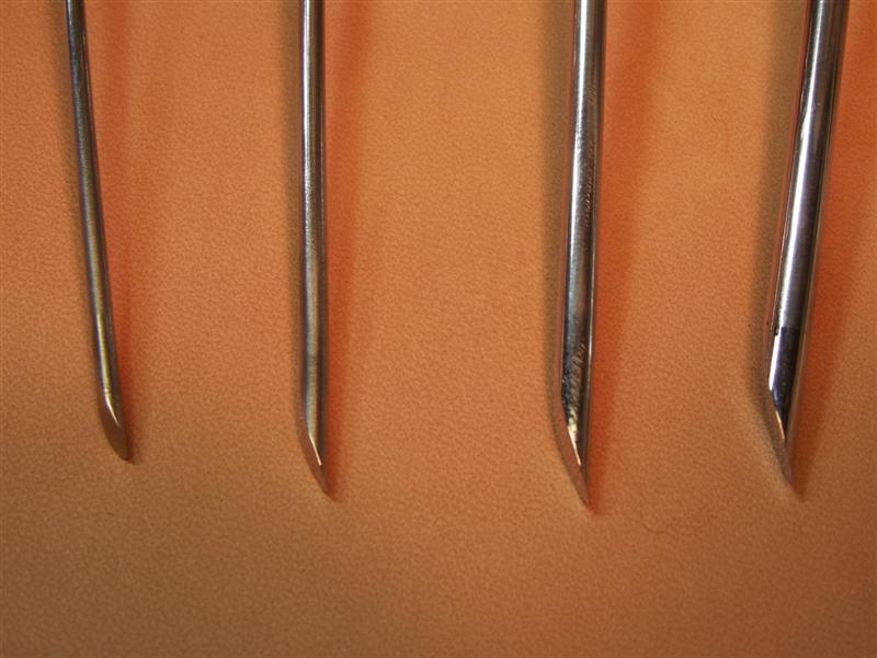

Here I have used each tool. From left to right, Craftool undercut beveler, Barry King, Bob Beard, Pro Petalundercuts_014__Medium_.jpg
And from top to bottom, Craftool, Barry King, Bob Beard, Pro Petal.
I find I use the pro petal tools the most for the effects that I like. I have several different makes of pro petal, Craftool, Osborne, Mosby. I think that Norm Lynds also makes them.
