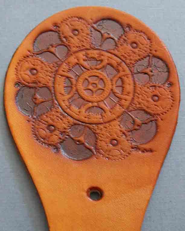

I have been stamping tooling leather, then using EcoFlo HiLite stain, which gives me the look I want......but then what can I finish it with. I tried the EcoFlo Super Shene and it was too glossy, so then I tried the EcoFlo Satin Shene......the problem with these is that when applying with a dauber, the stain starts to smear. I tried the EcoFlo Carnauba Creme, which gave me the look and feel that I wanted, but when you wipe it with a wet paper towel, it comes right off with the stain......so obviously it isn't waterproof. And then I tried SaddleLac, which works very well to seal it, but it ends up looking and feeling like plastic.

post-16724-0-21412800-1359308496_thumb.j
post-16724-0-47534700-1359308531_thumb.j
