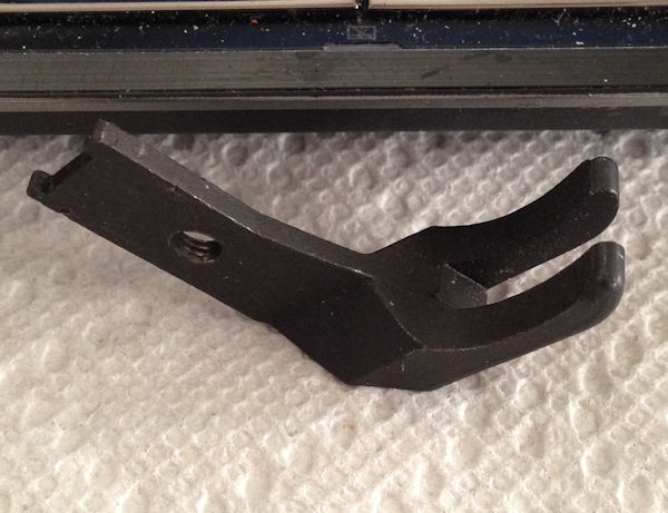

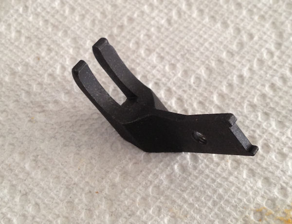

Could some of you other Boss users post pictures if your standard pressure foot, I'd like to see how they come from Tippmann.

purchased 29/12/11.
Hope this helps

That's what mine looks like mlapaglia. Have you noticed your needle guide hitting your prseer foot at all?
And thanks Billy for explaining what all you fixed, you obviously described it better then I could!
I have never had an issue with the needle hitting the pressure foot. Glad yours is working now
The key to immortality is first living a life worth remembering.
Bruce Lee
That is exactly what his looked like. Mine was much more refined looking and smoother but it had beveled edges in the center which funneled the needle guide down in. I don't know whether or not it came from the factory that way or not but I really think it did because I don't think the guy I bought mine from was the type to do that and he hardly used it, it was basically brand new when I got it.
I should have tried his foot on mine to see if it hit with that foot but I didn't think about it at the time.
The slight bevel did the trick though and instead of it hanging up on the foot it slid right down in between.
I think you could use a foot from a Singer 111w on the Boss, I think you might have to drill a hole in it though but I can't remember.
My presser foot looks just like the one pictured by mlapaglia.
I never really noticed my needle foot hitting one of the inside edges of the presser foot, but I do know that it is NOT centered in the space. Obviously it has to do with the dimensional tolerances between both the presser foot alignment and the needle bar. My machine has one of the "older" version needle bar assemblies. You can tell if it is an older version, if it does NOT come apart (needle foot removal) as is shown in the Tippman video. However, the needle bar assemblies are interchangeable, so if you have an older one and it needs replacement, the newer one will fit no problem.
