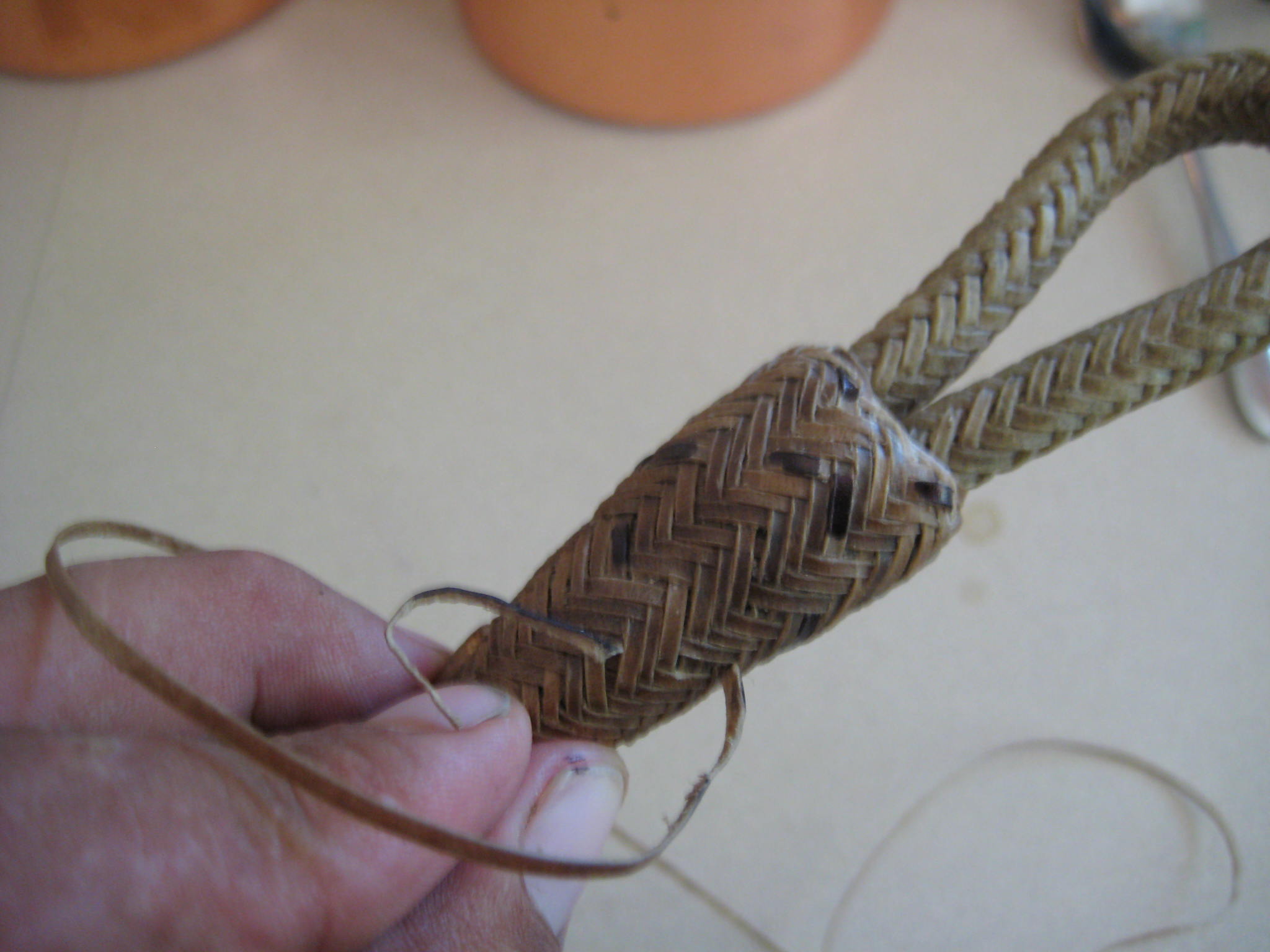

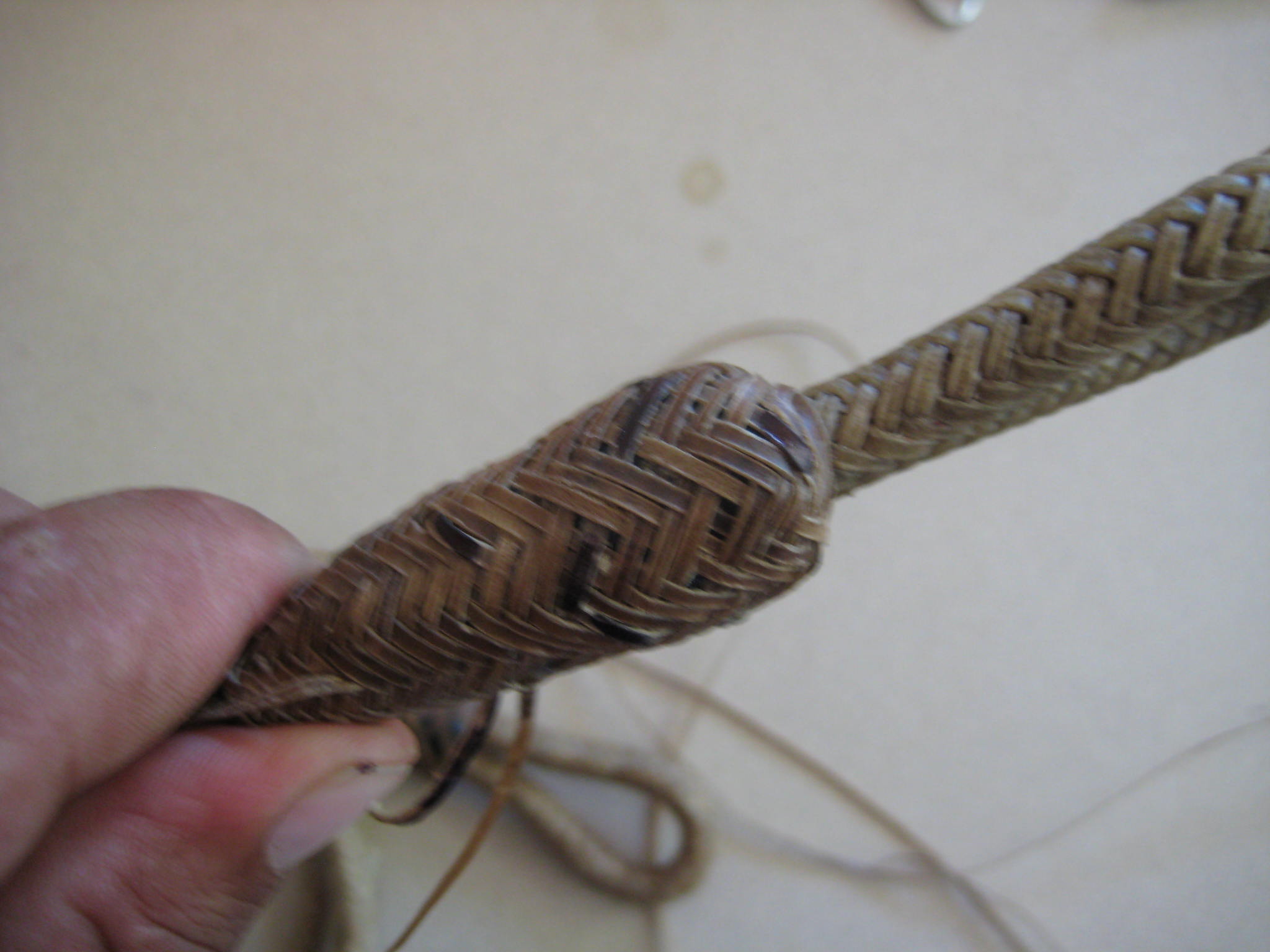

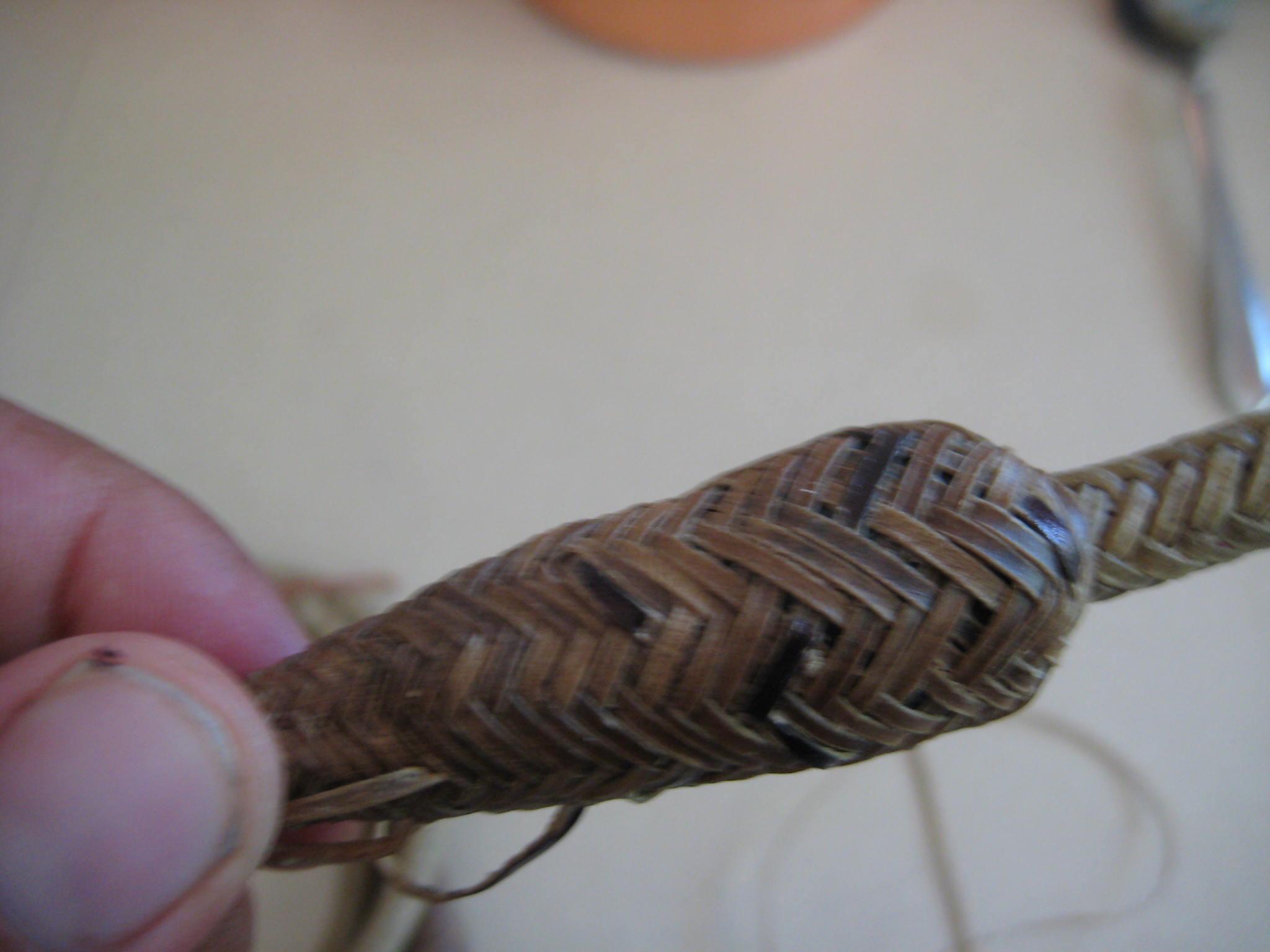

I'm going to attempt to post some pictures. I took a black marker to the string I'm working with hopefully making it easier to follow.

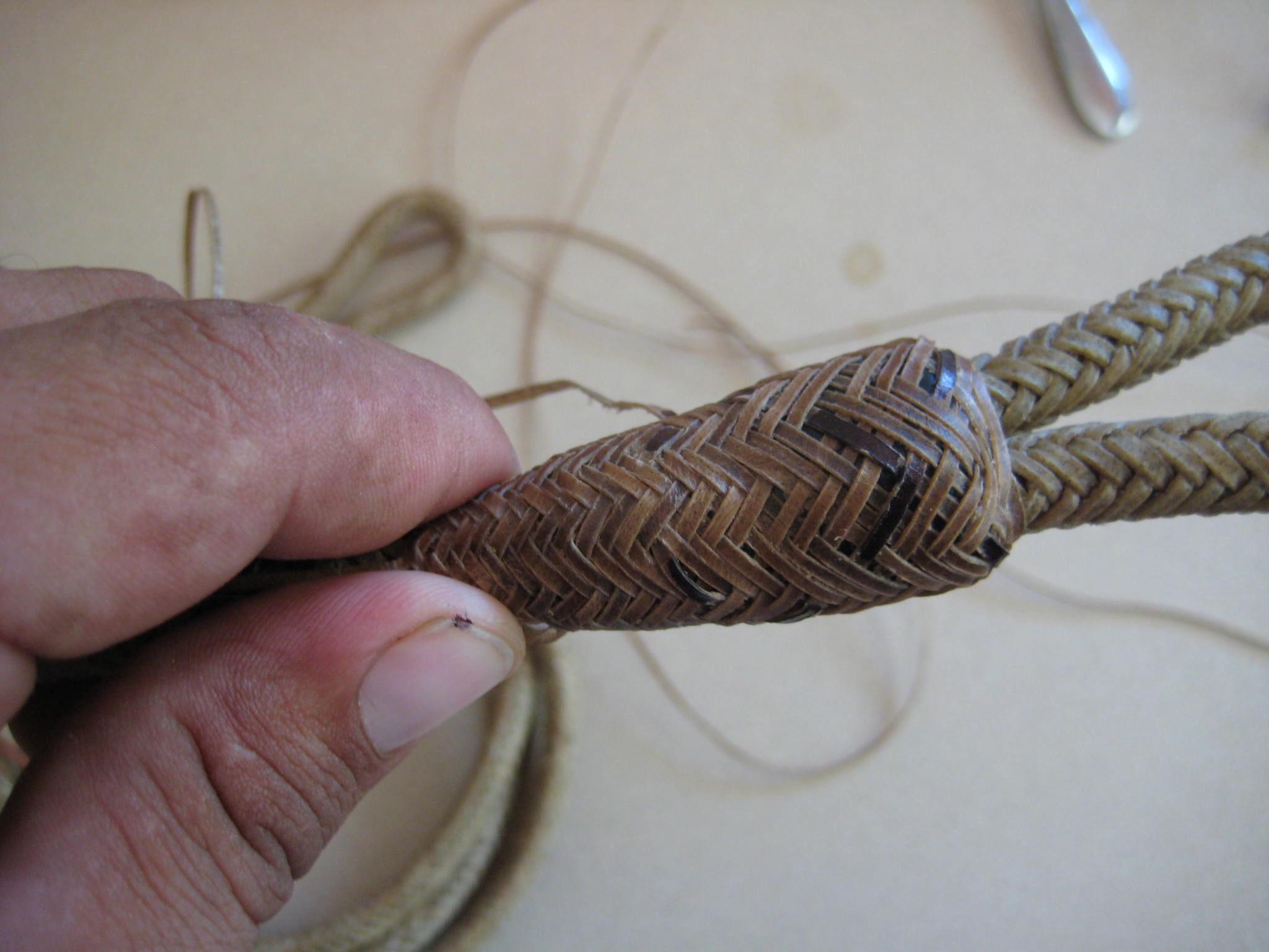

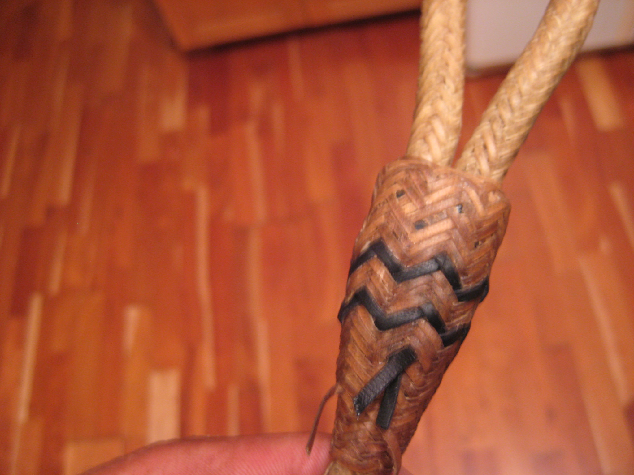

Posted (edited)
Here's two more
I can't figure out why I'm coming out at my starting point. I don't know if ya can see it but in one of the eight pictures after I went over three I had to go under four. And I don't think that is right.
Mike
Edited by rawhide1
This looks like a six bight knot, but can't be totally sure by the pix - I can see that you aren't going all the way to the bottom on the IW, and that's fine, as it should work the same, like you are doing it - the problem I am seeing is that when you are going up from the base, you are fine, following the left strand to the top, then under the cross, and splitting any pair there, which would have you basically going under 3...then, you have the mistake - you are coming down toward the base of the knot you are following the left string again - going down toward the base you should be following the path of the string to the right of your working end, and splitting any pairs that you've made on the previous passes going up - you will be splitting pairs you are making as you go down when you are going up again, and so on, around until you work your way back to the beginning of the IW...I might suggest a different colored string here, as it makes it easier to see when you are trying to 'see' the pattern...looks like it will make a nice button when it's done!
Shelly
If this is the third IW, it should be building up to an O/U three as you build and split pairs - I think if you back that string out, all the way to the beginning, start over with the entire string colored, to see it better, and go up following the string on it's left, and down following the string on it's right - you will find that it will work better - you will go under 4 at the bottom, to go up, but do be sure that you are coming out at that juncture next to the string you are following up (working end to it's right, both in the same spot, following this string up with it on the left of the working string - as you will split that pair when you come down to it following the string on the working end's right on the way down...make sense??)

Hey Mike, if you look at your second pic there is a pair that should have been split. Also, It is hard to tell but it looks like a 6 bight knot with an X=4 so basically you should have 24 rows of lines going up counting the "v" or at least the up leg of the "v" from bottom to top. When you go to the first interweave you are making an O2 U2 pattern and the ends are U3. The next level of interweave should be O3 U3 with the ends being U4 regardless of wether you are going all the way from top to bottom. The section you are "building" should be built in the same manner with the same formula of adding 1 to the pattern and 1 to the cross for each level of interweave. Make sure you are splitting pairs when you come to them. Seeing as this does not appear to be the first time you've come down the rows then you've made an error somewhere between the first and second pass. Make sure you are going up and down the same number so if you go O U O going up you should go O U O going down (this is leaving out the crosses at each end) and not O U O U O or some variation that adds one more row to the equation. From what I can tell you are basically one pass to the right of where you should be and you shoul be going down the row 3 strings to the right shich would put you coming to the pair that the start makes at the top of the pair. It also looks like you are too lose at the top and your interweaves are too far down the sides of the knot to fill in the gap at the top. This happens to me a lot. I REPEAT "A LOT" so don't feel too bad. just keep trying to feed those interweaves up higher realizing that you can braid the knot a little loose if you know that your next 3 interweaves are going to tighten everything up once they go on.
