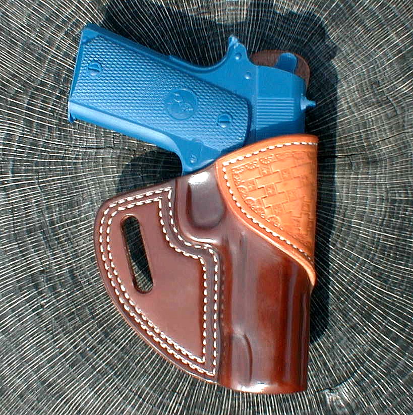

Frank Posted March 5, 2013 Report Posted March 5, 2013 I use W/C drum dyed leathers exclusively, along with their Oak. Here is a photo of one of my holsters finished with Bag Kote. Using different top finishes, you can either lighten or darken the finished product. It seems that Tan kote will give you a light lighter color than what I have shown here. Frank Quote
Members triage1998 Posted March 6, 2013 Author Members Report Posted March 6, 2013 I use W/C drum dyed leathers exclusively, along with their Oak. Here is a photo of one of my holsters finished with Bag Kote. Using different top finishes, you can either lighten or darken the finished product. It seems that Tan kote will give you a light lighter color than what I have shown here. Frank Frank is that the W&C brown skirting? Its beautiful! BTW nice work on that holster! Quote
Frank Posted March 6, 2013 Report Posted March 6, 2013 Thanks very much. Yes, that is the W/C brown skirting leather. Quote
Members Colt Hammerless Posted March 6, 2013 Members Report Posted March 6, 2013 That is a wonderful brown Frank! I have a couple of swatches of the different drum dyed leathers from W&C. I neatsfoot oiled it to see how it looked, but it didn't come out that dark, more of a light brown. This was a swatch from last year. I picked up another swatch a month ago, and it does seem a bit darker now. Curious as to what you're doing to darken it. Neatsfoot oil, or something else, maybe a combination? I bought a Chestnut belly from them in order to have some scrap leather for patterning, as well as to check out that color. Probably should have gotten a brown one too. Paul Quote
Frank Posted March 6, 2013 Report Posted March 6, 2013 Paul, Once I oil (mixture of neatsfoot and U-82 Saddlers oil), I use Bag Kote as a finish and the bag kote really helps to darken the leather. Tan kote will cause it to be a lighter shade of brown than bag kote. Frank Quote
