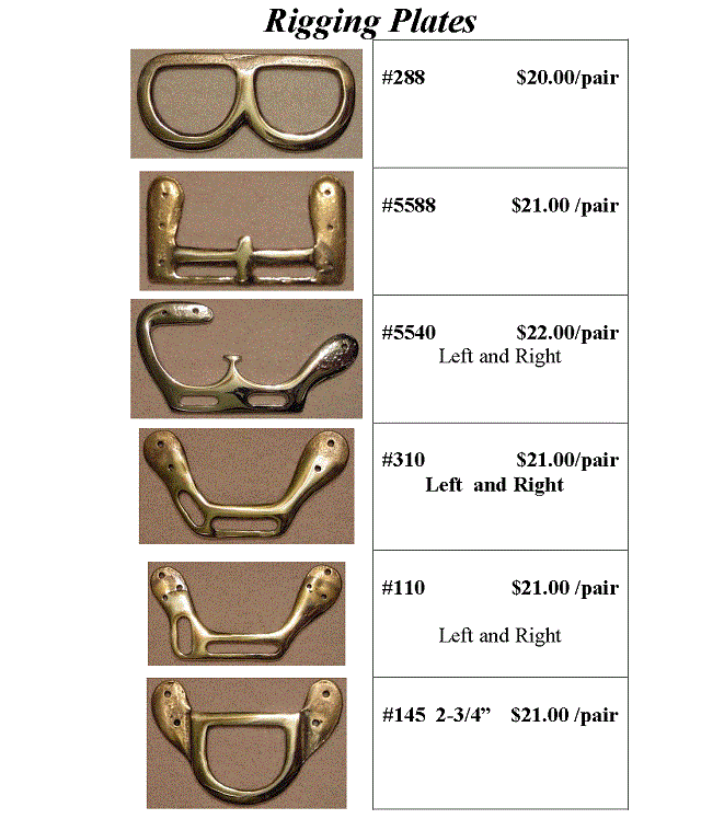

Members stef73433 Posted April 7, 2013 Author Members Report Posted April 7, 2013 I wonder, would one of these pictured give same affect? Quote
Members stef73433 Posted April 7, 2013 Author Members Report Posted April 7, 2013 Either very first or last one Quote
Members BOB BRENNER Posted April 8, 2013 Members Report Posted April 8, 2013 The rigging in the saddle was developed by Lynn McKenzie and Double J Saddlery and is what I would call a modified ring rigging. I do not think any plate rigging will work as the angles are not right. The closest thing that may work could be "Y" dee from Bork # 251 or # 633. The problem we have is that the rigging will not function the same way as the Lynn McKenzie and Double J Saddlery rigging. The question is how close does it have to be? Quote
Members stef73433 Posted April 8, 2013 Author Members Report Posted April 8, 2013 I guess wouldn't have to be exact, but I do like the different cinching options her ring offers. Quote
