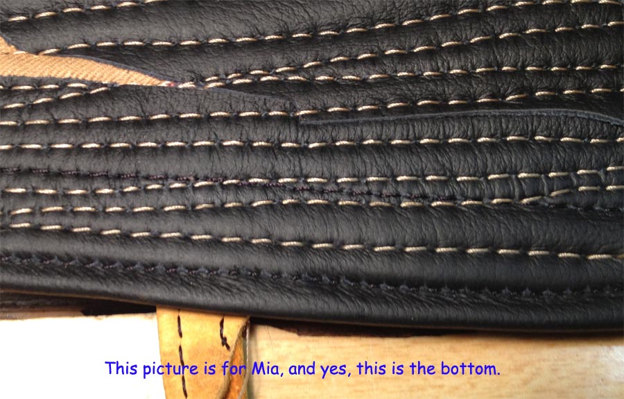

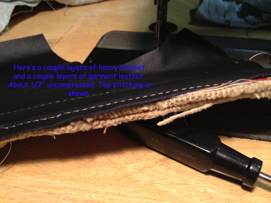

Members miaoreo Posted May 3, 2013 Author Members Report Posted May 3, 2013 Oh, and your thread breakage is likely related to the fact that you're not setting the stitch. There are loops left over from your previous stitch and the hook is simply coming around for the next stitch and the loop from your previous stitch is still there, so it grabs them both. This is characterized by a definate "snap" of of your top thread. Once you get your tension adjusted and the loops are pulled up properly, your thread will likely quit breaking. Most of all, have fun and don't get discouraged! Regards, Eric Eric... I can hear the "snap" now when the thread break. So does this mean the tension is too tight or too loose? and top or bottom tension? Thanks again for your time. Mia Quote
Members gottaknow Posted May 3, 2013 Members Report Posted May 3, 2013 Eric... I can hear the "snap" now when the thread break. So does this mean the tension is too tight or too loose? and top or bottom tension? Thanks again for your time. Mia Normaly, if your top tension is too loose or your bottom tension too tight, you'll get loops on the bottom. However, if your latch opener isn't set to open far enough, a loop will form and not get pulled up. The hook comes around and catches the newly formed loop as well as the previous one. The snap is the previous loop being broken. On occasion, you'll see a broken stitch yet the machine continues to sew. This happens on vertical hook machines when the needle bar is too low (timing issue), the hook timing is advanced (timing issue) or the latch opener isn't set correctly. It can also happen on thicker material even though it sews fine on thinner. You can also move up a needle size after adjusting your tension. A larger needle will allow a portion of the loop to slip back up the groove in the needle. This is especially true of bonded nylon where excessively large loops are an issue. Skipped stitches can also result as a loop that's too big tends to collapse sideways and get missed by the hook. If that happens, you'll get a skipped stitch and sometimes a broken one right after it. The one nice thing about verticle hooks is that you can put some scrap under the foot and open the cover and actually see what may be happening without standing on your head. I decribe the latch opener adjustment in that really long and often boring thread that is still fairly close at hand. Perhaps I'll give it a bump. Regards, Eric Quote
Members miaoreo Posted May 3, 2013 Author Members Report Posted May 3, 2013 Normaly, if your top tension is too loose or your bottom tension too tight, you'll get loops on the bottom. However, if your latch opener isn't set to open far enough, a loop will form and not get pulled up. The hook comes around and catches the newly formed loop as well as the previous one. The snap is the previous loop being broken. On occasion, you'll see a broken stitch yet the machine continues to sew. This happens on vertical hook machines when the needle bar is too low (timing issue), the hook timing is advanced (timing issue) or the latch opener isn't set correctly. It can also happen on thicker material even though it sews fine on thinner. You can also move up a needle size after adjusting your tension. A larger needle will allow a portion of the loop to slip back up the groove in the needle. This is especially true of bonded nylon where excessively large loops are an issue. Skipped stitches can also result as a loop that's too big tends to collapse sideways and get missed by the hook. If that happens, you'll get a skipped stitch and sometimes a broken one right after it. The one nice thing about verticle hooks is that you can put some scrap under the foot and open the cover and actually see what may be happening without standing on your head. I decribe the latch opener adjustment in that really long and often boring thread that is still fairly close at hand. Perhaps I'll give it a bump. Regards, Eric Ok I think what you are describing is exactly what is going on now. By sewing verrrrrryyyyyy slowly, like one stitch at a time. Basically slipping the clutch and turning the flywheel by hand. I can get it to sew the thicker material. The tiny tiny tiny screw for adjusting the bobbin thread tension I cannot turn. I took my screwdriver for my eyeglasses and tried. The slot in that screw is so shallow I can get no grip on it. The needle I am using is a Groz-Beckert 190 something, picture attached. What would be the next size... Needle sizing charts baffle me. And Yes, I know that is not the specified needle system for a 211G155 but those were too short. Quote
Members miaoreo Posted May 3, 2013 Author Members Report Posted May 3, 2013 Oh and in case anyone is interested. Here is what I am sewing... Mia Quote
