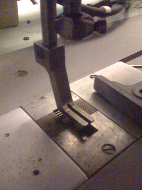

Trox Posted May 26, 2013 Report Posted May 26, 2013 Here is a pic of the Cowboy 2500 narrow harness foot that also fit the Adler. It is 10 mm wide and have a inside key width of 8,4 mm. ( to 8,5). The presser bar of my Adler 204-64 i about 7,5 mm, so the foot is a bit to big but thats no problem. When you tighten up the screw its no play in it. Cowboy bob ( Bob Kowar on Toledo Industrial sewing machine) sold me this one for about 50 to 60 $. Cowboy Bob is his member name here. I attach a bad picture of it on the Cowboy machine. Quote

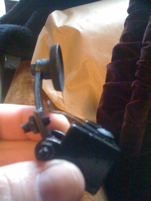

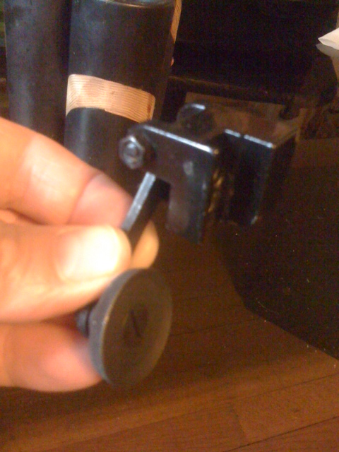

Members avimeso Posted May 27, 2013 Author Members Report Posted May 27, 2013 (edited) Here is a pic of the Cowboy 2500 narrow harness foot that also fit the Adler. It is 10 mm wide and have a inside key width of 8,4 mm. ( to 8,5). The presser bar of my Adler 204-64 i about 7,5 mm, so the foot is a bit to big but thats no problem. When you tighten up the screw its no play in it. Cowboy bob ( Bob Kowar on Toledo Industrial sewing machine) sold me this one for about 50 to 60 $. Cowboy Bob is his member name here. I attach a bad picture of it on the Cowboy machine. that's the foot I want for it. also need a spring for the roller foot, as it moves when I lift the foot due to having no spring. the bar on the machine is round is about 7mm. in a square shape Im trying to put a pic up. Edited May 27, 2013 by avimeso Quote

Trox Posted May 27, 2013 Report Posted May 27, 2013 Hi, thats the first time I have seen a picture of a 205-6. You will not be able to break that one, its built like a tank. Here you see a better pic (a bit better anyway) of the CB harness foot. Yes you got it right, thats the square bottom end of the presser bar. I do not think other than DA will sell you that spring, if any at all. I think you must buy a new roulette roller presser foot. Alternatively, just find a Little piece thin spring metal and drill a hole in one end. Then heat it and bend the other end slightly. You can use a thin metal saw blade HHS grade (grind of the teeth). You see on the pic how it works, it should be easy to make. You can also buy a foot like this (pic) at the same place and to about the same price as the other foot. I bought it from him, http://www.tolindsewmach.com/, he is a member here. Cowboy Bob, he normally reads all the sewing machine related topics. The foot you have will fit your machine better that this aftermarket one, so take my advice and fix it. If you are going to use old Adler machines you must be prepared to customize your own sewing feet`s. Not much are available for these anymore, you can do it. Good luck Tor Quote
