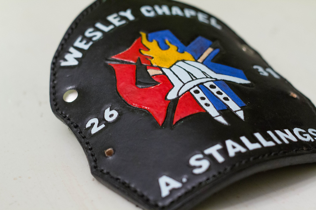

Members agentilly82 Posted May 22, 2013 Members Report Posted May 22, 2013 NEW TO THIS FORUM! I want to start making my own fire helmet leather shields for friends and family but I'm not sure what equipment I need to get started. I would like to stamp the letters and carve the artwork myself. What type of paint do I use and tools should I buy? thanks all! I attached a picture of a helmet front I did in like 30 minutes. I was testing Ideas... -Alex Quote
Members rawhide1 Posted May 23, 2013 Members Report Posted May 23, 2013 Alex Welcome to the forum brotha! When I make shields I use Round knife Straight knife Contact adhesive Dye Edger Saddle soap and old jeans(for slicking edges) Sewing machine If you want to carve your #'s or letters or a design You'll also need Swivel knife Bevelers You can substitute some of the tools such as use a razor/box knife to cut your leather and you can hand stitch if you don't have a machine. I just started using oil based model car paint on radio straps I make. I was using a latex paint and it didn't hold up well. I'll have to see how the oil based paint holds up. I'm sure I missed some stuff and hopefully some others well jump in. Best of luck, Mike Quote
