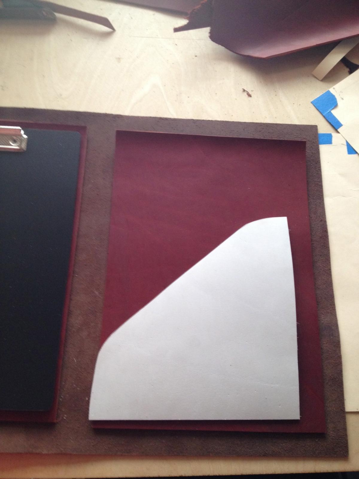

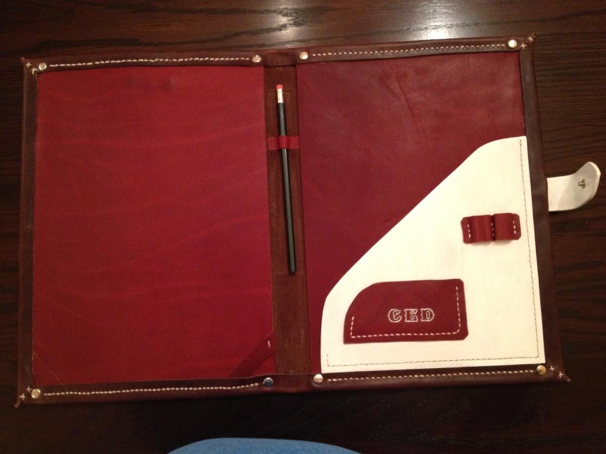

Members WScott Posted August 31, 2013 Members Report Posted August 31, 2013 Hello all, would like some input on this project to get some other ideas before I plunge into assembly. I am making a leather portfolio for my son. He is left handed so I have modeled a design from a "pleather" portfolio that I used in University. The writing pad is on the wrong side for him, so new design is for writing pad to sit on the left, clip above it, pocket on the right, fold down the middle and a leather tab and snap to close it. We want a plastic solid writing surface on the left. I have cut out the 4 main leather pieces (back, sides x2, pocket) and am especially pondering how to : 1. Attach the plastic clip board to the left side so there is a solid writing surface or maybe have it slide in and out? 2. Do professional looking edges...idea was from the back folding to the inside? Skiving will be a B as I will have to do it all by hand, but oh well The photos show the rough pieces cut out, I have a 3/4 inch seam allowance from the back for the edge fold over I am open to any thoughts, as I have had great luck with other eyes giving me great new ideas. photo 1: the model photo 2: loose assembly 4 pieces photo3: plastic writing surface for left side photo 4: right side with white pocket Quote
Members shtoink Posted August 31, 2013 Members Report Posted August 31, 2013 Neodymium magnets might save you some hassle with the tab. They are available in an insane variety of sizes. The cool part is that you would really only need one magnet and a small metal disk. These could even be scavenged from some other source. I've seen them used to hold the tab closed on the box that some fancy soap comes in, so it seems very plausible. The thin metal disk would get placed in between two thinner layers for the tab and the magnet would be embedded behind the leather in the cardboard, or plastic, layer of the cover. I'd also think that the pen/pencil holder might be nicer if it were placed vertically along the spine where the fold is. I always felt it interfered with the feel and was too easy for it to fall out placed where it is on the one you are using as a model. It also seems to leave dents in the paper, too. That's just WRONG! Quote
Members WScott Posted August 31, 2013 Author Members Report Posted August 31, 2013 Ooh, like a rare earth magnets to hold the clipboard in place???? Great idea!!! Then I wouldn't have to glue it or stitch it down permanently and he could remove it when he wants I have some Lee Valley earth magnets sitting on my shop desk I was looking for a paper clasp like on the original, but could only find the cheap clasp from a dollar store folder I could re-work the folder in wood or kydex too, but would want to find a better clasp See, this is why I posted before plunging ahead Fire away with more ideas to help the design challenged Quote

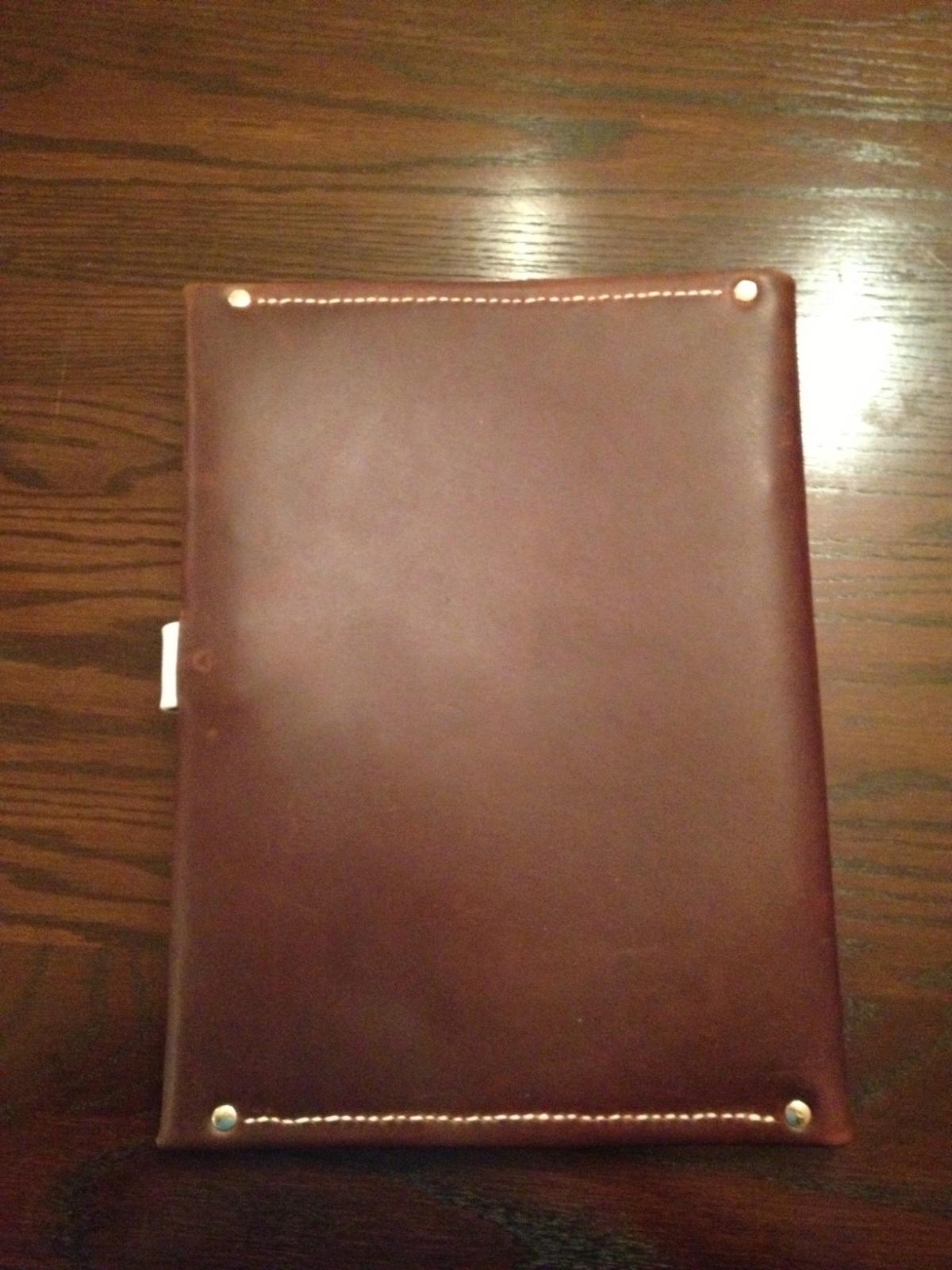

Members WScott Posted October 29, 2013 Author Members Report Posted October 29, 2013 So this is how it turned out. Thanks to all who helped out with this. My son loves it and as I overheard him telling his mom "dad will tell me all the things wrong with this, but it's awesome" I do see lots I could improve on, but it is one of a kind and his now. Quote
