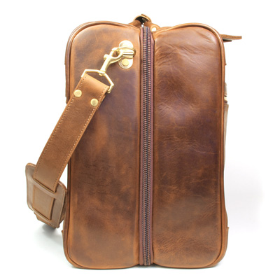

Members Procyon650 Posted September 2, 2013 Members Report Posted September 2, 2013 I am planning to build a leather carry on bag similar to the one in the attached pictures. The case construction is not too difficult but I need to have a hinge that will swing through 180 degrees. I was thinking of using a piano hinge but they are usually narrow and work best on a quite rigid box, and how would the metal hinge be attached to the case?, Would a leather strip sewn on as a hinge be adequate? Maybe a very heavy piece of cloth webbing sewn as a hinge and then covered in leather. Is there another method I am unaware of? The commercial made bags I have looked at use custom hardware I cannot source. Any suggestions? Quote Carpe Pisca!!
