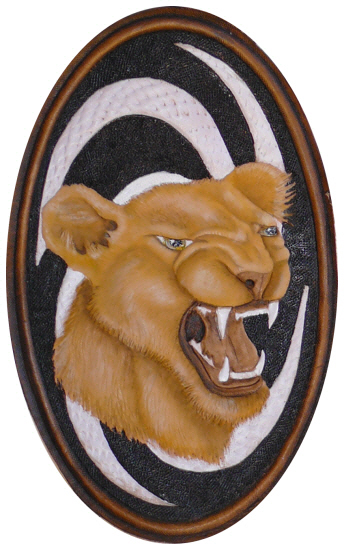

I did an experiment some 5 years ago with artist oil paint (Talens "Rembrandt") and had no problems at all with a sticky surface.
My experience with oil on canvas was to leave it to dry around 5 weeks so I did a similar timeframe for the leather. I then sealed it with Angelus acryllic finisher and it worked beautifully.
My oilpaint is quite "oily" in itself so I did take some out by having the paint on paper towels and more used a "dry brush" technique painting the motif. I did not use oil as a medium but artist terpentine (small amounts). After the drying persiod I added some pure neatsfoot oil, a few more days of drying then the sealer.
I have to say that this is the most beautiful "painting paint" I have done on leather, it's way more interesting to look at than the ones painted with acryllic paint.
Here's the old piece today...
Ps . The white in the background is acryllic paint, I think it showes.
