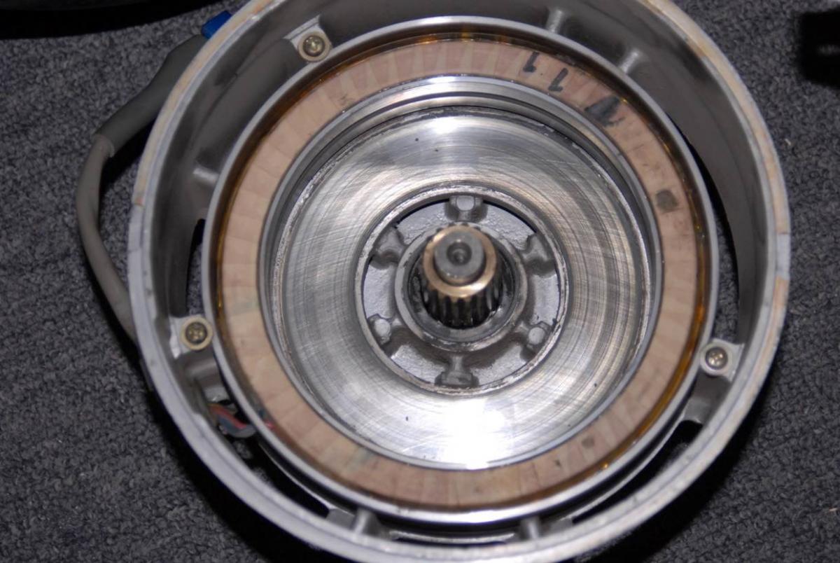

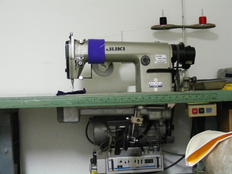

Members photopigiste Posted October 30, 2013 Members Report Posted October 30, 2013 (edited) Hi ! I have an old Juki DDL-555-4 , it was a servo auto clutch motor , the servo box is defect. and i can' t find it ,the motor is like brand new ,there is 2 rubber disks in the clutch ,i have removed all eletronics on my sewing machine ...Can i fit an ordinary clutch on this motor ? Edited October 30, 2013 by photopigiste Quote
Members Gregg From Keystone Sewing Posted October 30, 2013 Members Report Posted October 30, 2013 Yes, you can. We have ripped off dozens of motors from electronic under bed trimmer machines that were in the 30 year old range. The Juki DDL-555 was always a great model. Quote
