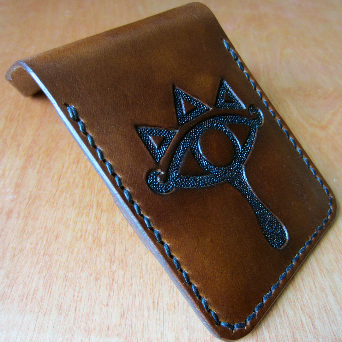

I'm considering buying a leather sewing machine to help grow my part time leather wallet business and I was wondering if a Tippmann Boss would be suitable. I live in an apartment so I have very little space available. I am renting a garage at the apartment but the power is limited and I'm not sure if it could handle an industrial machine motor. I might start branching off into belts and bags as well at some point. Any advice would be appreciated.
