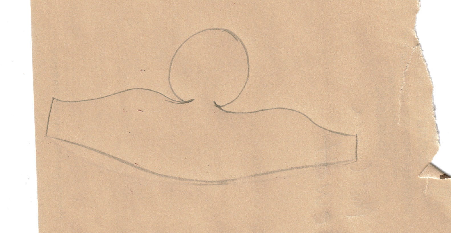

Members tnestes Posted September 26, 2008 Members Report Posted September 26, 2008 Many saddles today have horn caps with the stitching all the way around the horn, and finished with a mule-hide wrap. When you really think about it, especially after covering a horn the traditional way with wings AND NO FINISHED HORN WRAP, this new method is something of a cop-out. Please don't take me wrong, I do this method, too. Anyway, I'm going to be covering a duckbill type horn (lots of underbelly), 4" non-finished cap, with about a 3" diameter neck,and at a 28 degree pitch. Could somebody send me a sketch of how to shape the wings on the initial pattern? Also, I use a latigo choke strap to tighten up and finish the wings on the final procedure. However, this burnishes the wings to the point that they do not want to take any dye or antique. What can be done about this? THANKS to any of you pros who might render some advise! Ted N. Estes tnestes@yahoo.com Quote

Members steve mason Posted September 26, 2008 Members Report Posted September 26, 2008 Many saddles today have horn caps with the stitching all the way around the horn, and finished with a mule-hide wrap. When you really think about it, especially after covering a horn the traditional way with wings AND NO FINISHED HORN WRAP, this new method is something of a cop-out. Please don't take me wrong, I do this method, too. Anyway, I'm going to be covering a duckbill type horn (lots of underbelly), 4" non-finished cap, with about a 3" diameter neck,and at a 28 degree pitch. Could somebody send me a sketch of how to shape the wings on the initial pattern? Also, I use a latigo choke strap to tighten up and finish the wings on the final procedure. However, this burnishes the wings to the point that they do not want to take any dye or antique. What can be done about this? THANKS to any of you pros who might render some advise!Ted N. Estes tnestes@yahoo.com Ted here is a very quick sketch of a wing style horn wrap, you will have to adjust the pattern to fit the type of horn you are covering. In regards to the "cop out" cap and wrap style horn cover. They are in now way a cop out, in my opinion they are very well suited to a wood post horn, if your horn is covered after the swell you do not have to cut such a large hole or split the back of the swell to fit the swell over the horn. Using a cap & wrap style horn cover will not distort the hard work my treemaker has done to put a correct shape to the horn neck, which should be designed to have your dallys run down the horn, when the wing wrap style is installed on a wood post horn it can add to much leather in the wrong place on the neck which can affect the way your dallys run. This is not always the case but it is something to consider when covering the horn. Also the horn cover is something that can take a lot of abuse, therefore it is something that may need to be replaced in the future, the cap & wrap styles make a much better repair job. And one of the main reasons behind a wood post horn is roping, so your dallys can slide on a horn with a large circumference with a mulehide type wrap, then your mulehide wrap will cover up all the hard work you did on a wing wrap. So for many reasons I feel the cap & wrap is the way to go on wood post horns, metal horns are the place for wing wraps. I don't believe that anyone should do a cap & wrap with out a mulehide style horn wrap as they do not look as finished, but then whats the point of building on a wood post horn without putting a mulehide wrap on it anyways. On a side note, just a little suggestion in how to ask a question, there are many polite ways of asking for help, maybe starting off a question by saying that something that many of us do is "copping out" when we are actually doing something that just plain makes sense, might not be the best way to ask for help, it comes off as abrasive, I am sure that was not your intent but that is how it reads on my end. hope the info helps. Steve Quote check out www.stevemasonsaddles.com check out my saddle blog
Members tnestes Posted September 26, 2008 Author Members Report Posted September 26, 2008 (edited) Ted here is a very quick sketch of a wing style horn wrap, you will have to adjust the pattern to fit the type of horn you are covering. In regards to the "cop out" cap and wrap style horn cover. They are in now way a cop out, in my opinion they are very well suited to a wood post horn, if your horn is covered after the swell you do not have to cut such a large hole or split the back of the swell to fit the swell over the horn. Using a cap & wrap style horn cover will not distort the hard work my treemaker has done to put a correct shape to the horn neck, which should be designed to have your dallys run down the horn, when the wing wrap style is installed on a wood post horn it can add to much leather in the wrong place on the neck which can affect the way your dallys run. This is not always the case but it is something to consider when covering the horn. Also the horn cover is something that can take a lot of abuse, therefore it is something that may need to be replaced in the future, the cap & wrap styles make a much better repair job. And one of the main reasons behind a wood post horn is roping, so your dallys can slide on a horn with a large circumference with a mulehide type wrap, then your mulehide wrap will cover up all the hard work you did on a wing wrap. So for many reasons I feel the cap & wrap is the way to go on wood post horns, metal horns are the place for wing wraps. I don't believe that anyone should do a cap & wrap with out a mulehide style horn wrap as they do not look as finished, but then whats the point of building on a wood post horn without putting a mulehide wrap on it anyways. On a side note, just a little suggestion in how to ask a question, there are many polite ways of asking for help, maybe starting off a question by saying that something that many of us do is "copping out" when we are actually doing something that just plain makes sense, might not be the best way to ask for help, it comes off as abrasive, I am sure that was not your intent but that is how it reads on my end. hope the info helps. Steve I said (quote) "please don't take me wrong." I'm not sure how much nicer I can be. I also said I do it as well. My sincerest apologies for appearing "abrasive." THAT WAS NOT MY INTENT AT ALL. The only thing I'm trying to do is get some help and ideas. I certainly appreciate your sketch, too. Edited September 26, 2008 by tnestes Quote

Members jwwright Posted September 26, 2008 Members Report Posted September 26, 2008 Ted..........you quoted here... "I got to thinking about this after reading an article by Dick Sherer where he stated something to the effect that he'd feel a little cheated if he removed the mullhide wraps from many 4K saddles today and saw some of the tree." Ted..........this is the part that I don't think was understood correctly. The method by which I, and many others cover a wood post horn after the swell cover is on, and by sewing all around............does not leave any of the horn or tree uncovered. Perhaps you have not seen that method. I personally, am now starting to cover steel horns in the same manner, except those for show or arena cutting saddles. Steve gave a good rough pattern, so I won't bother posting mine that I mentioned previously. It's all about personal preferences,and what works best for the customer,and the intended use of the saddle. JW Quote www.jwwrightsaddlery.com
