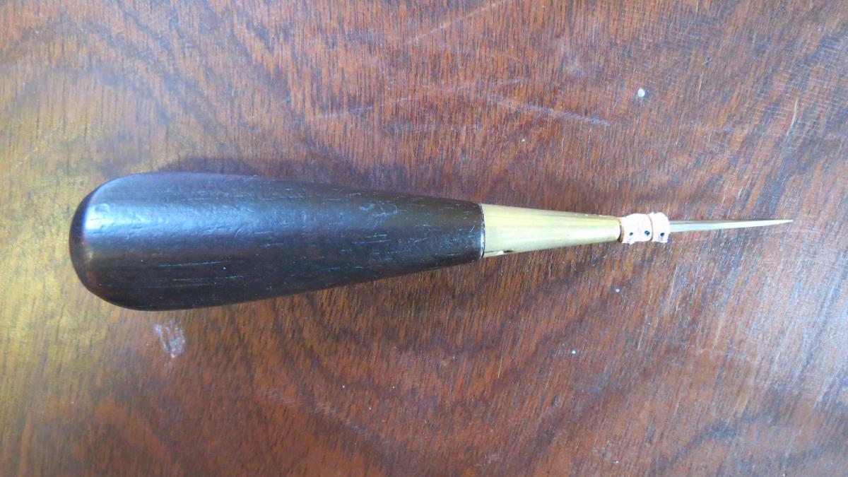

Members Basically Bob Posted December 10, 2013 Members Report Posted December 10, 2013 (edited) I started off with an Osborne awl but have settled in with a vintage awl. Just feels good in my hands. Overall length is about 5.5". I really like the narrow brass tip which is just 3/16" wide (because it allows me to get very close to the stitching line). The exposed blade length is approximately 1 1/2" long but I have 3 leather washers attached to the blade and this reduces the working portion to about 1 1/8". The leather washers help me control the depth of my strike. The blade is 2.5mm wide. I use Dixon pricking irons; 7 s.p.i. the chisels of the pricking irons are 3mm wide. I use 5/18 line thread. Works for me. Edited December 10, 2013 by Basically Bob Quote
