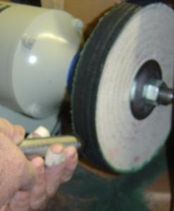

Tree Reaper Posted December 11, 2013 Report Posted December 11, 2013 I'm trying to find out what the thread is on this tool so I can make a handle for it. The handle that comes with it has the self centering pin pressed into it and I can't use it to sharpen the cutting punches on my wheel. I contacted Osborne and they are treating it like a trade secret. It appears to be a bastard thread so they may be using their own thread. If I can't find out here I'll take it to a machine shop. Thanks. Kevin. Quote

Tree Reaper Posted December 11, 2013 Author Report Posted December 11, 2013 I have SAE and Metric thread gauges Tom and I can match the thread but the diameter of the thread doesn't match the standard threads. I checked pipe threads and couldn't find a match also but I know you can make any thread you want on a lathe and I'm pretty sure that's what they've done. When I find out everyone will know. They would have been better off just telling me instead of making it a Big deal. Quote

Tree Reaper Posted December 12, 2013 Author Report Posted December 12, 2013 All I was looking for was a piece of threaded rod or pipe to thread on the cutters in order to keep my fingers safely away from the buffing wheel when sharpening. They must think I want to sell the information to China. Osborne is now at the very bottom of my tool supply list. I'll buy from Japan before buying another Osborne tool. I know the machine shop I work with can duplicate the thread on a piece of brass or aluminum rod in a matter of minutes. So long Osborne! Quote

Tree Reaper Posted December 12, 2013 Author Report Posted December 12, 2013 For sure, I'll keep you posted on the results. It's amazing how something so simple can become so complicated. I know it's a copy right issue for them but I'm not asking about the process they use to make the tool, they didn't invent the thread and because it's a bastard thread you can't find it at the hardware store so it seems like a case of paranoia. Quote
Tree Reaper Posted December 13, 2013 Author Report Posted December 13, 2013 Well I just got back from the shop and they did a perfect job of turning out a tool I can use to sharpen these Osborne cutters safely. Quote
Members TomG Posted December 13, 2013 Members Report Posted December 13, 2013 OK. So spill the beans.... Did they have any idea of the thread size? Quote Tom Gregory Legacy Leathercraft www.legacyleathercraft.com www.etsy.com/shop/legacyleathercraft
Tree Reaper Posted December 13, 2013 Author Report Posted December 13, 2013 (edited) The beans are, it is a standard 14tpi on a diameter .600" which makes it a bastard size and not common. A standard 14 tpi is usually found on 7/16 hardware. Edited December 13, 2013 by Tree Reaper Quote
