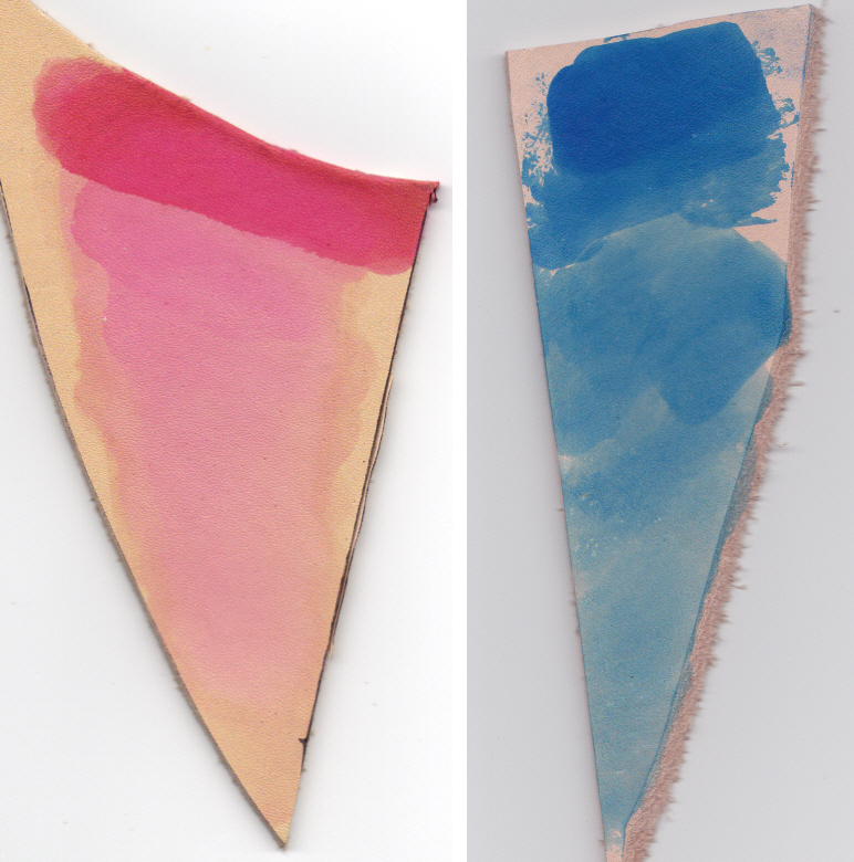

Members Tina Posted December 21, 2013 Members Report Posted December 21, 2013 I think you might be after that bright yellow that makes the pattern? Most dyes I know of need some clear mix, a deluter solvent is your best friend when using dyes. If the yellow (any color) is to dark, delute it until you're happy. I guess with Eco you use water, with Fiebing use denature alcohol etc. With my Angelus yellow dye I delute it at least 50/50 to get that bright yellow, make some test pieces on the side but make sure to let it dry (hair dryer makes it quick) before deciding if you're on the right track :-) I enclose a picture that I have shown many times before (a picture says more than a thousand words) it explans so good what a deluter really can do for you when dying...This is made with Angelus light blue and light pink + some alcohol, going from undeluted to a mix maybe around 10/90 or so. Quote

Members Cyberthrasher Posted December 21, 2013 Members Report Posted December 21, 2013 Yeah, you'll just need to thin the yellow you have. I know Fiebing's yellow is tan when used full strength. Start with 50/50 and go from there. Quote
Members Lividya Posted December 21, 2013 Author Members Report Posted December 21, 2013 Good to know. I guess that using a resist would help as well, because even with block dying, I haven't near getting such a clear result. I will try with the fiebing yellow and reduce it some, because I agre that the full strenght color looks a lot more like tan than yellow. Thank all for your good counsel! Quote
