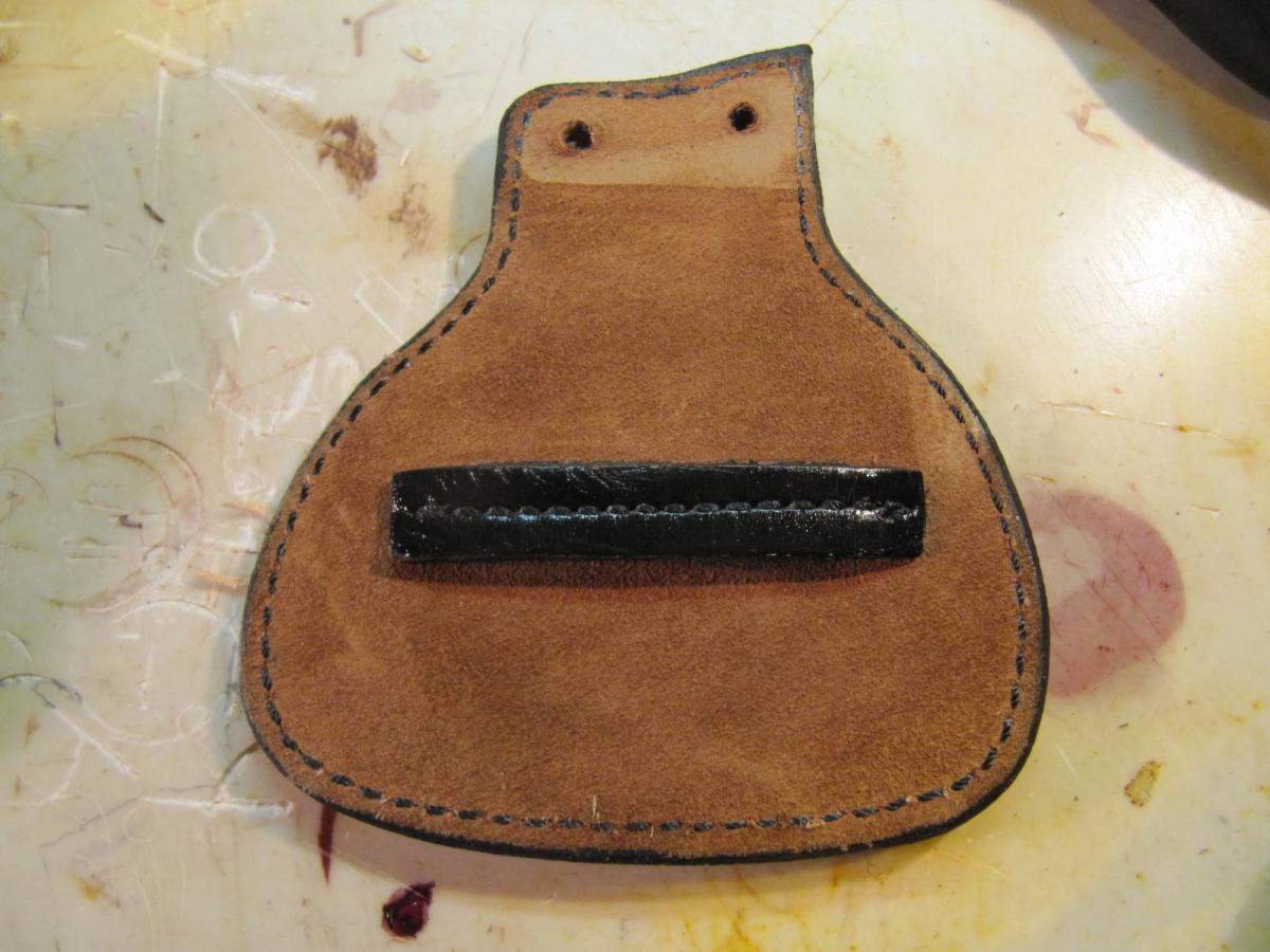

camano ridge Report post Posted January 8, 2014 (edited) Ike, here are some pictures that might help you, again I use tee nuts burried in the leather asndwich. the one picture shows a snap around belt loop that also acts as a spacer between the paddle and the holster. Even if you don't us a loop I would still put the spacer in there. Hope this helps any questions just ask. Edited January 8, 2014 by camano ridge Quote Share this post Link to post Share on other sites

camano ridge Report post Posted January 8, 2014 The belt loop was done at customers request. It is to keep the holster from pulling up, however it is some what redundant since there is the stopper strip on the paddle. The other purpose of the belt loop is depening upon where you wear it on your belt it may butt up a gainst a pant belt loop this helps keep it from sliding around. Paddle holster do have a tendancy to move around. You will find that the strip on the paddle is more effective then a strip on the back of the holster. The paddle is between the belt and the body so when you draw if the holster pulls up the strip will hit the bottom of the belt and is trapped between the belt and the body so has no place to go. If it was on the back of the hoster it might hit the bottom of the belt, however ther would be nothing to keep it from pulling away from the belt and pulling up. Quote Share this post Link to post Share on other sites
