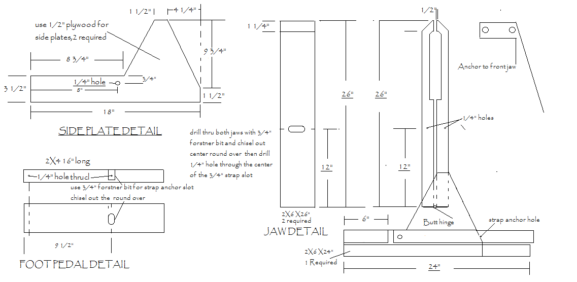

Members St8LineGunsmith Posted February 19, 2014 Members Report Posted February 19, 2014 heres a diagram and a pic of my stitching mule it is pretty simple to build. I used a forsner bit with a drill press and a wood chisel to slot the 2x.6's heres a pic of the one I have now and it is the best one I have used IMO here is the original design Quote No Matter Where Ya Go There Ya Are. Chattown Leatherheads American Plainsmen Society Society Of Remington Revolver Shooters(SCORRS) THE SUBLYME & HOLY ORDER OF THE SOOT, (SHOTS) The St8 Line Leathersmith I was Southern Born, I am Southern Bred And when I Die I will Be Southern Dead! I fly this Southern Flag Because my Ancestors Flew it in A war to ensure our God given rights against a Tyrannical Government. Heritage Not Hate!

Members danboy295 Posted February 19, 2014 Members Report Posted February 19, 2014 St8line, I really like the leather strap holder for your hand tools. That is a great set up, I'm going to borrow the idea for me workspace. Quote Visit my Etsy shop Axis Leatherworks for NERF holsters and accessories
Members St8LineGunsmith Posted February 19, 2014 Members Report Posted February 19, 2014 Works rather well, everything is right there in one neat place easy to locate the tool I need Quote No Matter Where Ya Go There Ya Are. Chattown Leatherheads American Plainsmen Society Society Of Remington Revolver Shooters(SCORRS) THE SUBLYME & HOLY ORDER OF THE SOOT, (SHOTS) The St8 Line Leathersmith I was Southern Born, I am Southern Bred And when I Die I will Be Southern Dead! I fly this Southern Flag Because my Ancestors Flew it in A war to ensure our God given rights against a Tyrannical Government. Heritage Not Hate!
