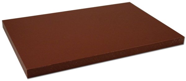

Chief31794 Posted February 24, 2014 Report Posted February 24, 2014 I've got one of these Professional Cutting Boards that I've had in the shop for about 3 years, it's the same material a lot of clicker boards are made of, a little pricey but they last a long time, I am at the point that I need to sand mine down a layer and you can do that several times as well. Tandy sells them for $99.99 retail or $70.00 if you have an elite membership. One of the few tools Tandy has that still works well. Chief Quote "Life's too short to carry ugly leather"
