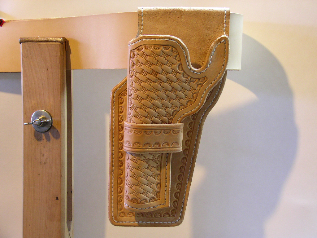

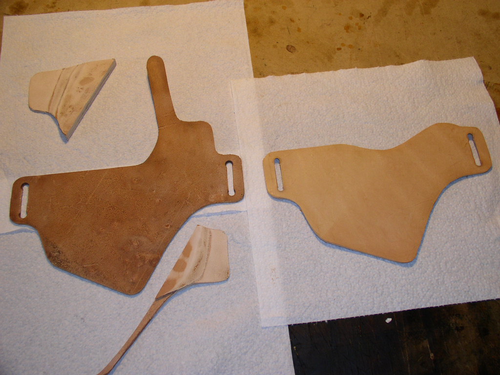

You can get by with some pretty basic tools, a razor knife, a good pair of scissors, a hole punch, a stylus to transfer a pattern to the leather, needles and thread, stitching pony, leather glue and a few other items. You did not specify what type of holsters, there are two basic types, western revolver and modern automatic pistols. The How to make holsters book by Stohlman is good for revolver basics and there may be some good ones for autos but I can't think of any right now. This forum has a lot of good info. I am sure others will chime in and there are some other threads on the site with lists of tools and such to get started. Have fun and expect to do a lot of experimenting. Here are a couple of examples
